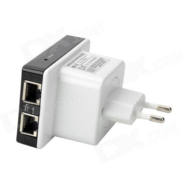

    After looking at THIS, I learned it's possible to connect the Dreamcast online at today's Internet connection with the Dial-up modem using some specifics devices, like a particular router, a line simulator, and, if you want to increase the data transfer, a V92 serial modem.
    So, I was thinking... How about create a single device combining the devices cited above? It could be a single, small device, with two Ethernet jacks (one jack for in and other for out), and two phone jacks with line simulator, plus wifi if possible (in visual, it can look something like THAT DEVICE). With such device, could be possible:
    • To put devices where a phone line is required to connect them at Internet using today's Internet connection;
    • Link two devices to play P2P softwares in the same place, not requiring to use a phone line do this job. It even can use a software to allow two people to play, through the Internet, a dial-up P2P game;
    • Connect up to two Dreamcasts at the same device to play a Internet required online game, where can be possible connect online to access a public server, or connect to a local PC to play using a personal game server. Using the last option, two devices can be used to connect up to four Dreamcasts to create a LAN Party.
    This device could be used not only with Dreamcast, but with any other console or device with a dial-up modem to connect at Internet using a dial-up connection, or to connect two consoles with a P2P system.
    In other words, even a dial-up modem for Saturn, PlayStation 2 or GameCube, (and even old PCs and other consoles) who uses a software who asks for a dial-up connection and are incompatible with broadband adapters can "rise from your grave" with such device.
