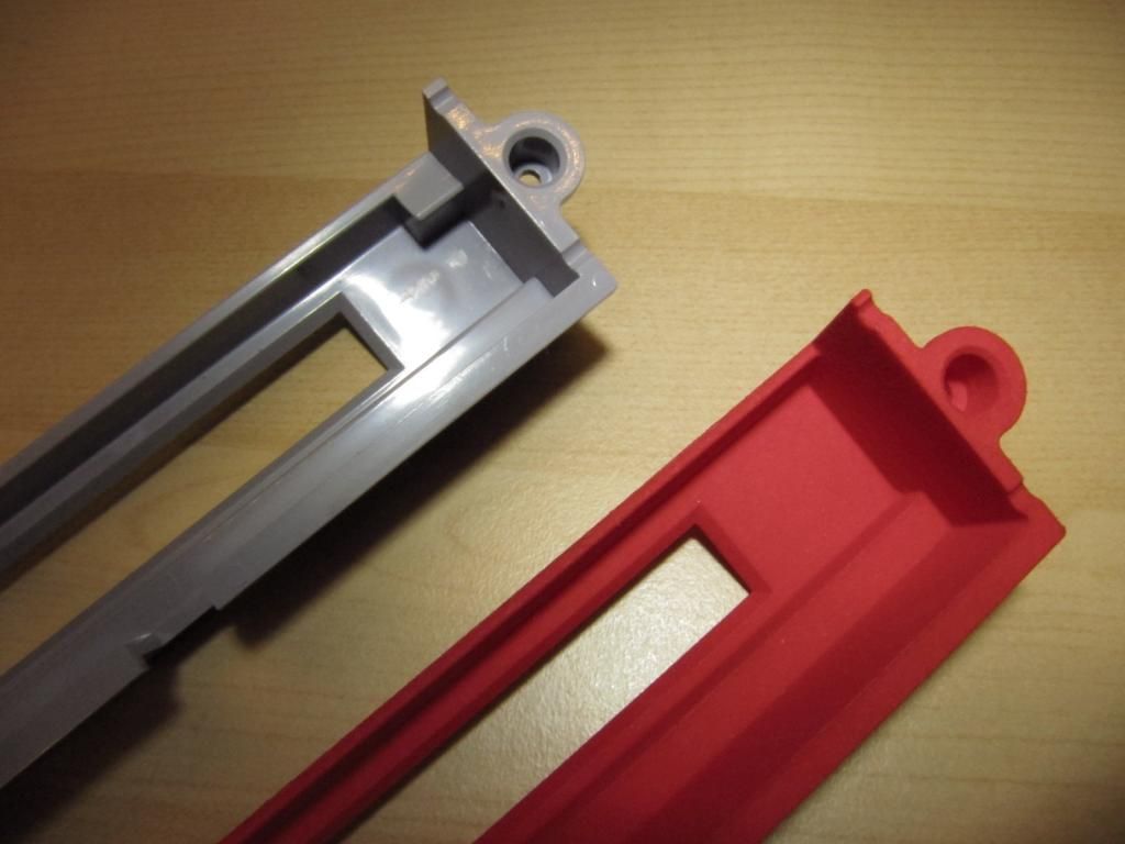

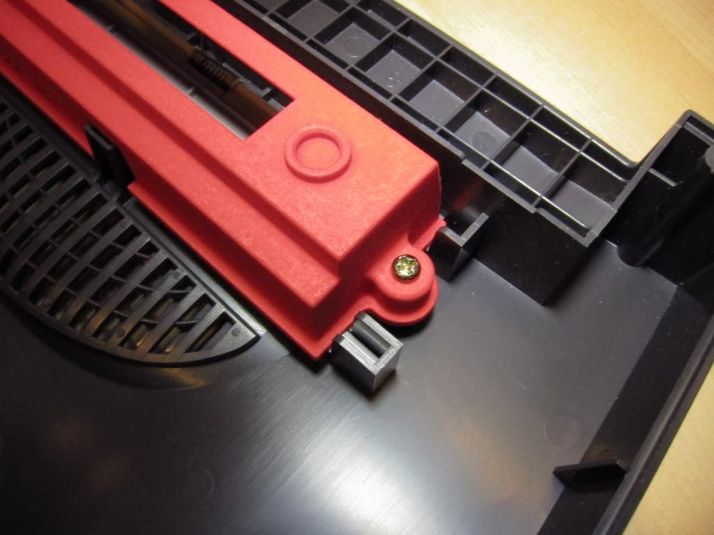

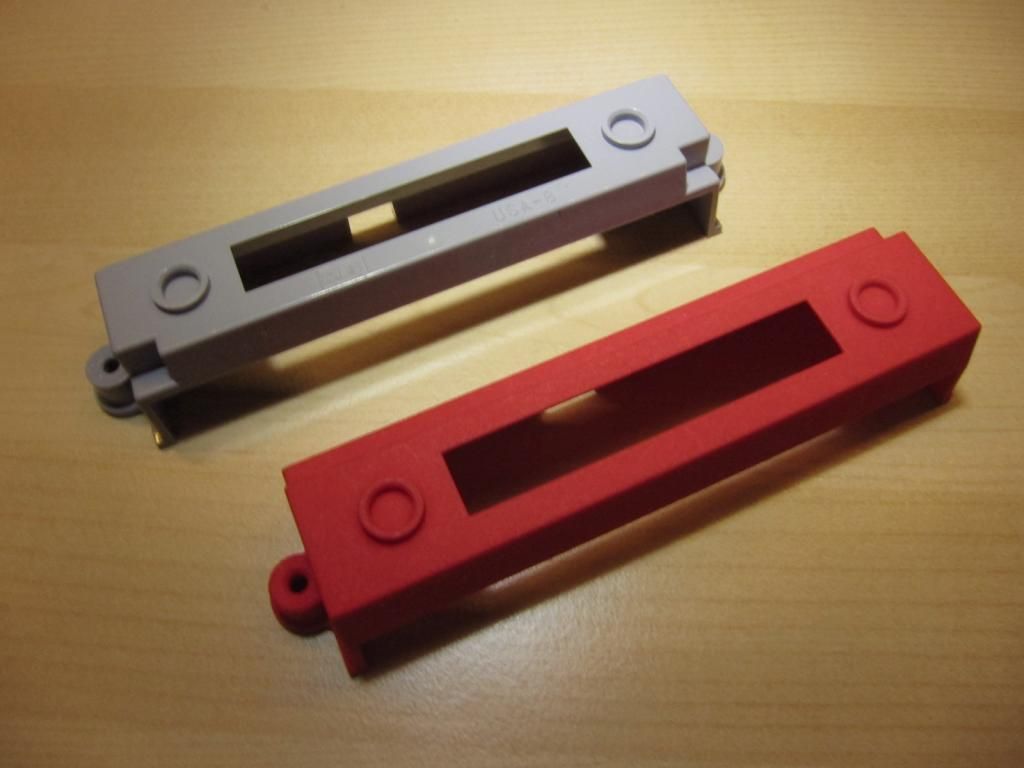

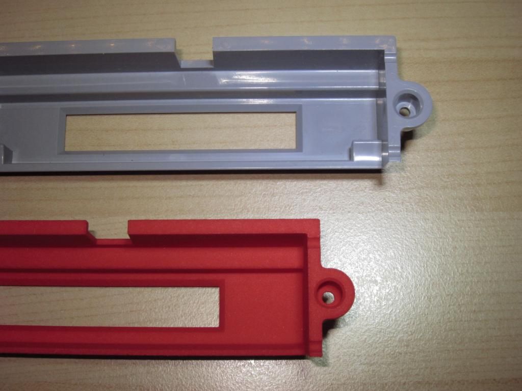

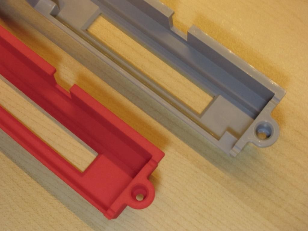

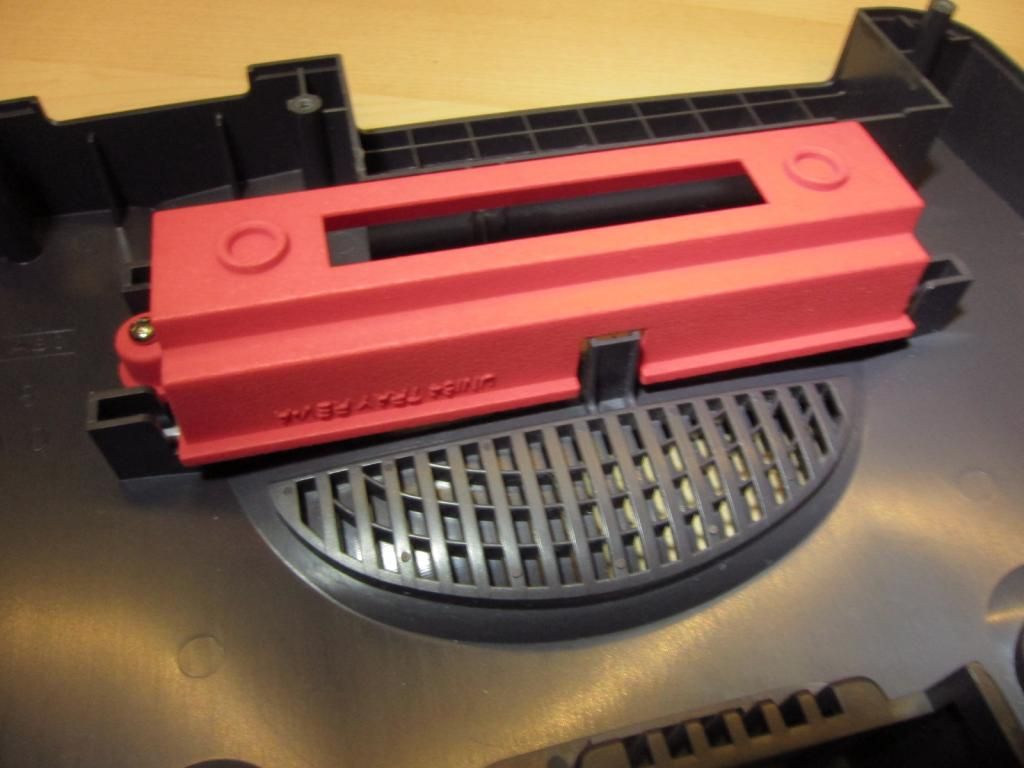

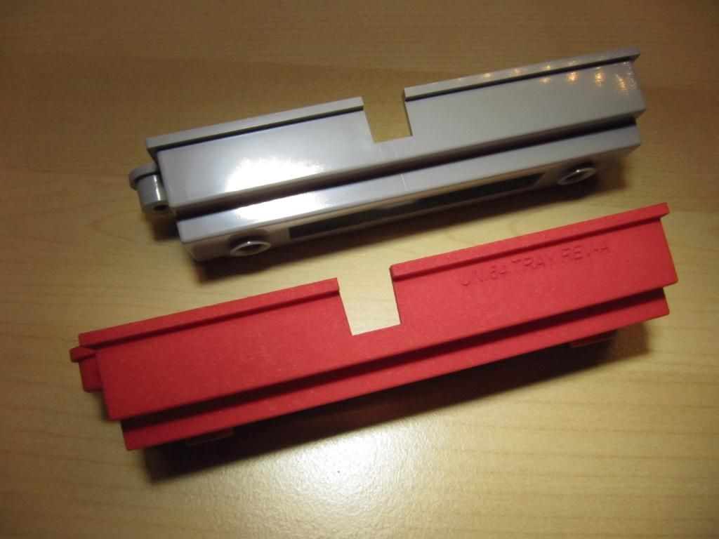

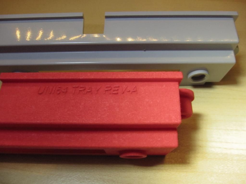

    Happy New Year everyone! I designed this part few months ago but only had the piece printed professionally at the end of December. After reading ASSEMbler's New Year message I thought I'll kick off this year with this piece. Granted, it cost just as much as what I paid for this particular N64 at a Goodwill store, I do share the same sentiment as ASSEMbler so in the end I feel it's still worthwhile to have it printed. While it's technically feasible to have a "complete printable case" as ASSEMbler forsees, unfortunately the cost will be prohibitive today as this tray demonstrates. Perhaps in a few years the price will improve. Meanwhile a small piece like this is still a good start.
    I'm well aware I could of just Dremel the two notches off like what most people do or just simply get a Gameshark, but what's the fun in doing that? I don't collect PAL region games so this is good enough for myself.

    Thank you Borman. I'm not a big N64 collector. I only own a couple of plain American N64s. I only have the tray dyed red to match the expansion memory pak. I'm sure other colors will match better with other exotic N64 colors.
