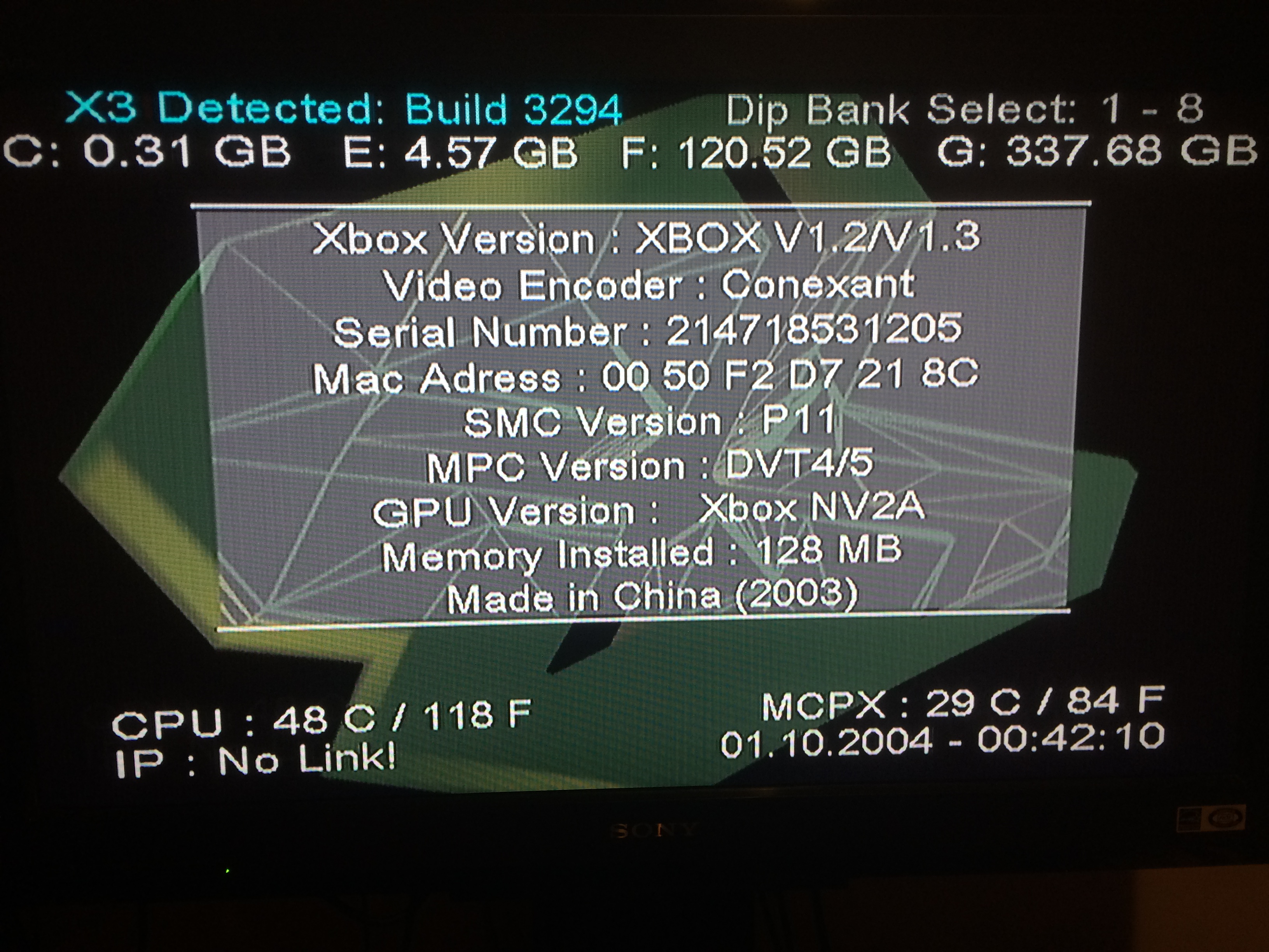

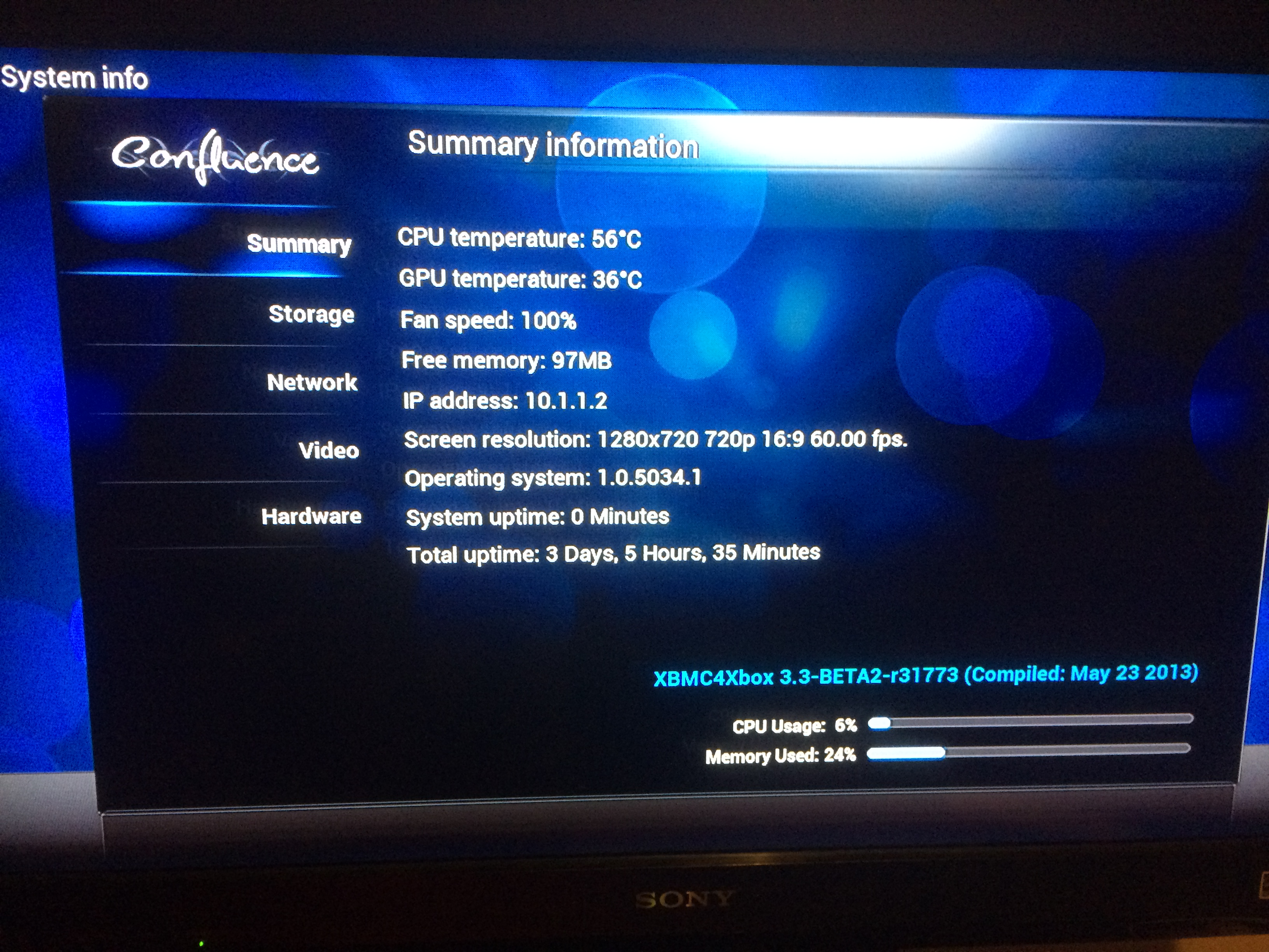

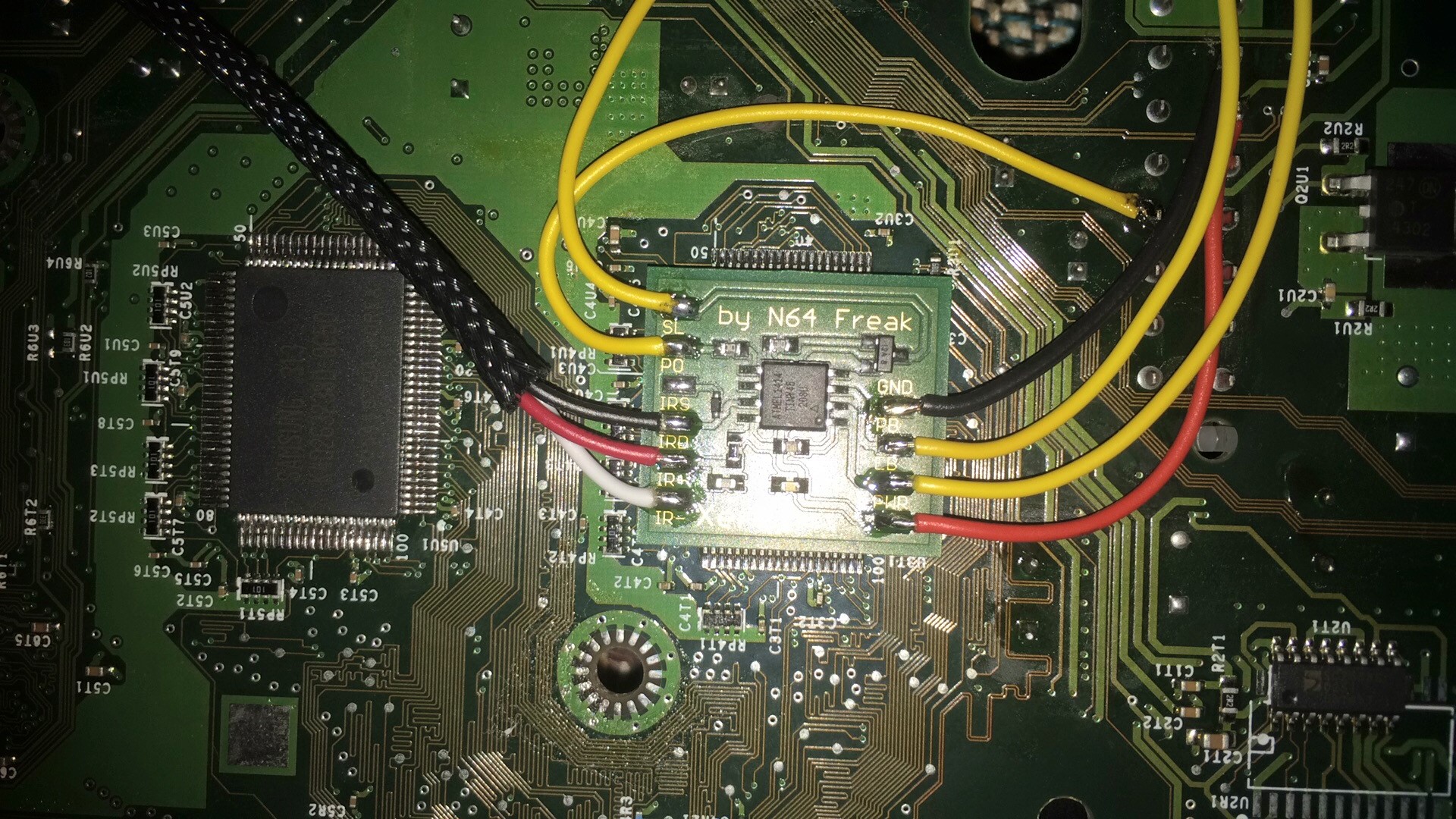

    First off I want to thank N64 Freak for all of his hard work and time that he has put into this for everyone, he has come a long way from a 1ghz, to a 1.4ghz, to a speed switch adapter. So here are some pictures of the board I received.
    The board I received was very clean (shiny like) all his solder points were professional. I was very excited to have this board in my possession. I want to first point out that I bought a trusty board a while back, it basically came down to where I had to scrap the board and I paid $357 CAD plus shipping for it. This was the first time I ever bought a board from trusty, when I received his board it was in really bad shape.
    So while examining N64's board, he had installed a custom black heatsink on the new CPU, its a tiny bit taller than the retail but only millimeters and yes this upgraded board can be installed to a retail box! No cutting Hard drive trays or nothing, just pop it in and go. Trustys board comes with a flatter longer custom heatsink that is so long he had to solder/bend capacitors over to have it installed and where the heat sink is so thin it has a small fan bolted to the top of it. Note you have to have a cut DVD tray to use his boards.
    The Temperatures of N64's Board are great it Idolizes around 58C-63C Max at 100% fan Speed, the black heat sink is specifically glued to the CPU and will not come apart, same with the GPU. The Black Clips that Microsoft had to hold down the retail heatsinks are completely removed and the CPU is not held down by Epoxy.

    The 128MB of ram that N64freak installed was very professional and looks retail like Microsoft did it themselves. I installed an X3 CE Chip to this board and it booted up flawlessly. When I had my trusty board I just couldn't get the chip working what so ever where I gave up and used the basic X2 TSOP that was on it.
    Now N64's Board comes with a Pre-installed TSOP as well so no worries on having a chip installed or not.
    I had N64s board running for 2 days playing Homebrew, emulators, games etc. Of course you need to patch DEFAULT.XBE files to make some things run better but you had to do that with any upgraded board, even dreamX. but I had no problems with heat, freezing, conditions or work to the board. I had him install one of his Xerc 2 XE Chips to this board which is a great combo if you're looking to buy an upgraded board from him. (Xerc's cost extra)
    I want to point out something on the speed switch adapter of N64's board, he has a 2 pin female connector on the adapter where you can choose to have the wire to connect to a rocker switch. The CPU always runs at full 1400MHZ until you have that rocker switch connected you can also Specify a Color of LED you want to have on the adapter. I have a transparent console which the LED shines right through which is nice (I have a cut hard drive tray though). Trusty's adapter had two wires soldered to it where you had live wires or a rocker switch which you had to tuck into the Xbox until you drill a hole in the front for it. It cant be detached unless you de-solder the wires on the adapter which risk damaging it.
