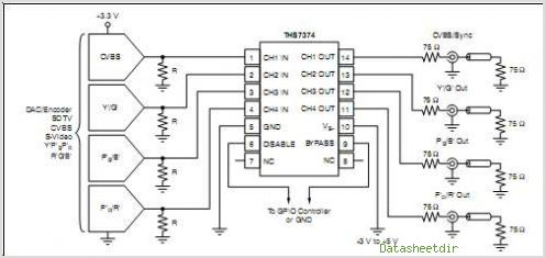

    Despite this being a different amp, with the resistor in series after the amp and the resistors to ground in the PAL cable, you end up with something like this:
    But with just the 3 RGB lines

    I realize this is irrelevant at this point but
    This diagram reinforces what I said. The 75 R to GND you're referring to is actually the TV's termination resistor on the far side of the transmission line (coax cable). There is no 75 R to GND at the jack.
    The PAL SNES is the only device with a 75 R at the jack because it purposefully uses a screwed up termination topology. Hopefully this clears it up:
