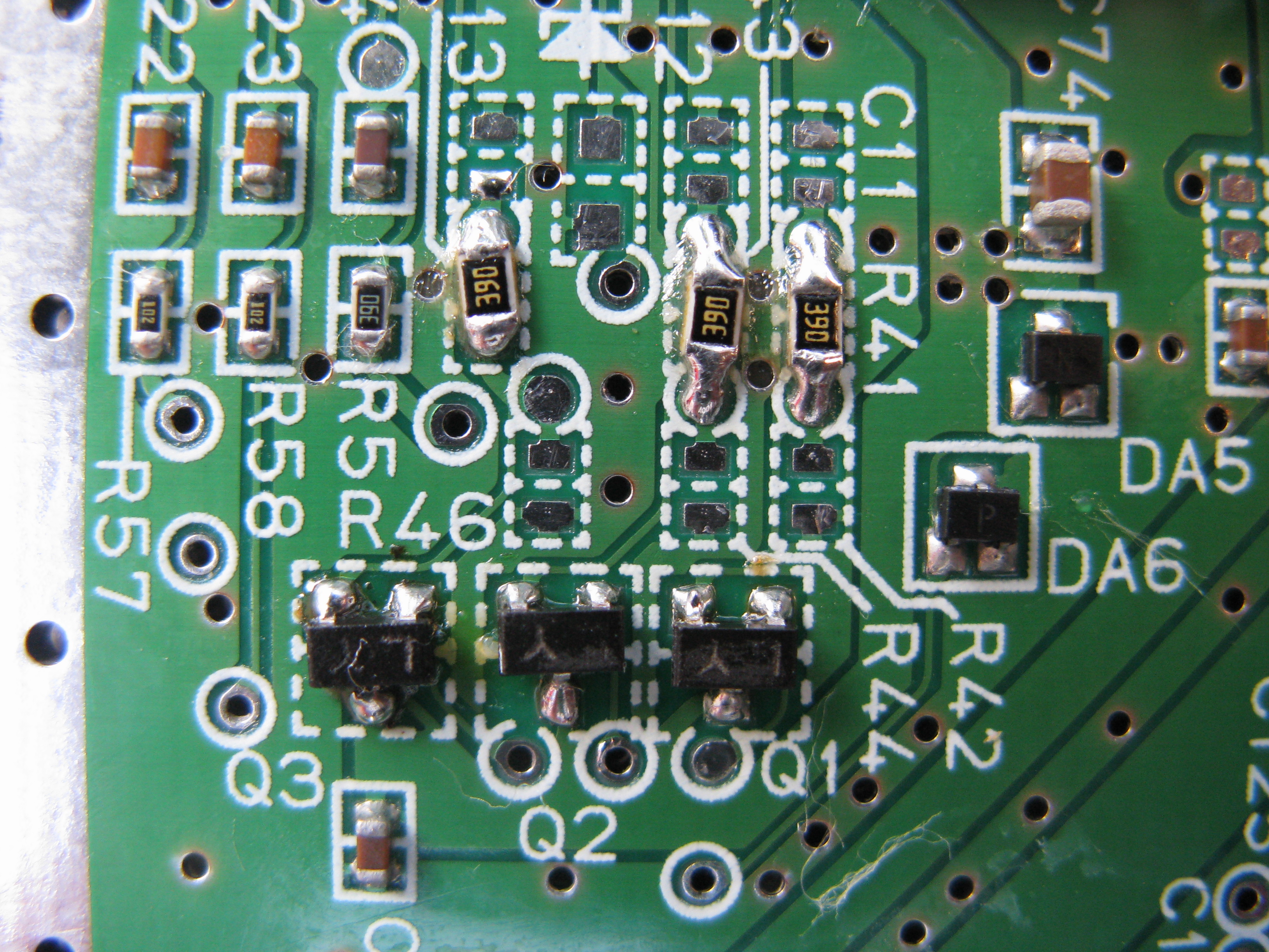

N64 RGB Mod - Poor quality image
Discussion in 'Modding and Hacking - Consoles and Electronics' started by fathertime, Jul 16, 2011.
  1. Segata Sanshiro
    Segata Sanshiro speedlolita
    Aug 5, 2009
    1,279
    That's much much worse than my day 1 soldering..
  2. brainpann
    brainpann Site Supporter 2012
    May 1, 2011
    403
    Yeah, it makes me feel loads better about my first soldering attempt.
    It kind of looks like they held a lighter to the solder and hoped for the best. :)
