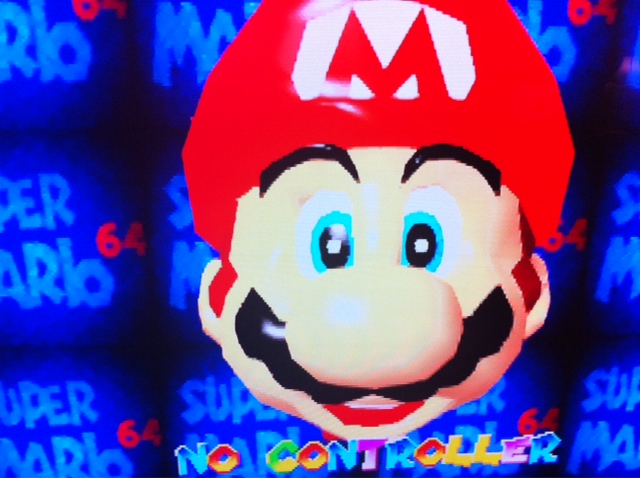

  13. fathertime
    fathertime Rapidly Rising Member
    Jul 14, 2011
    82
    Sorry to dig up this old thread but I too have this slightly dark screen problem using the c-sync hack (cut composite and link the pins on the multiout port). The R, G and B lines are amplified through the THS7314 chip and it is a bright stable picture with composite sync (however with the X net pattern). Using c-sync the image has no X net pattern but I must admit that it is a little dark. Picture attached.
    Tonight I put a 75ohm resistor in series on the C-sync line after reading your comments but no change.. I just turn the brightness up to 100% though you can still notice it on dark games like the ghost house in Mario64.
    Can you tell me more about this method of getting a bright picture if one has already modded using using the THS7314 and C-Sync with the PAL Gamecube Scart cable?
    Many thanks!

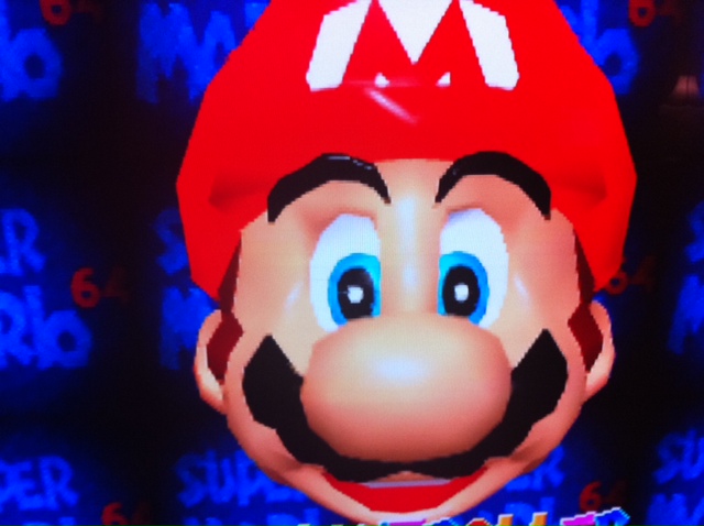

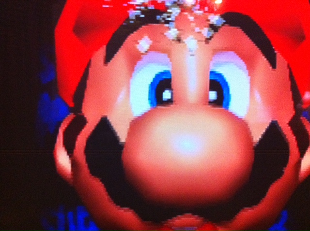

  14. fathertime
    Jul 14, 2011
    82
    Hi Gorgyrip, I re-read your post and see now that you are actually using the svideo Y luma pin 7 instead of the c-sync pin and linking that to the cut composite video pin for sync. You also have a 75 ohm resistor (in series I assume?)
    So anyway, I've done this and left the THS7314 amp on the R, G, B lines in - but now the picture is too bright!! (see attached pic)
    Did you take the THS7314 amp out? So close to getting this resolved once and for all...
