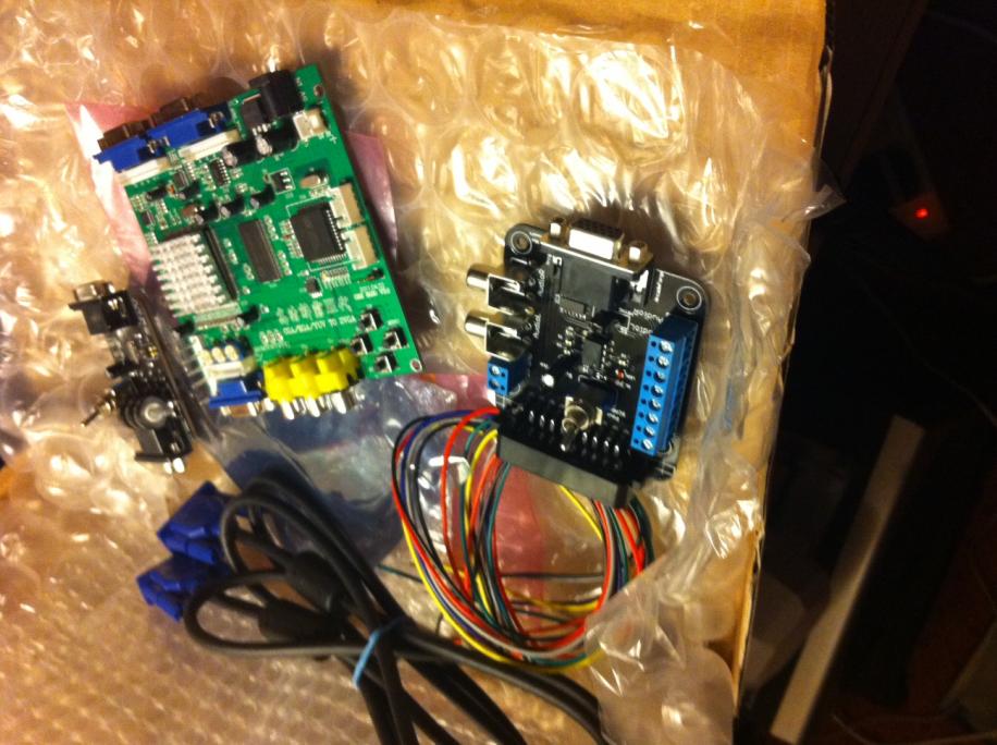

  18. fathertime
    fathertime Rapidly Rising Member
    Jul 14, 2011
    82
    This package arrived :clap:
    Looks like you need to order the VGA cables separately so no testing just yet... :-(
