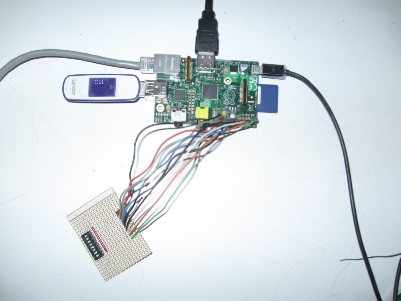

    And this is my dip switch selector... a little ugly but functional ;)
    The hdmi cable is there for testing purpose. This is a minimal but functional distribution so you can login and in case run or modify the python scripts. What's not present is the graphical environment (and a lot of other things) just to remain at a minimum size.
    By the way, you can still run the games the old way, i.e. without dip switches as wrote on the site.

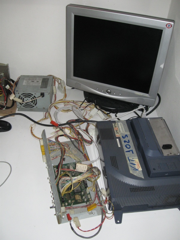

    A picture is worth a thousand words :)
    So are you already set ? Have you all the things going ? Does the game/board (not the net dimm) works ?
