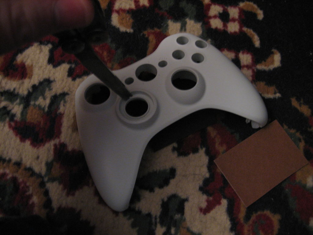

    1. The DIY Fix of Sanding a surrounding gap along the circular rim to give the D-Pad more room.

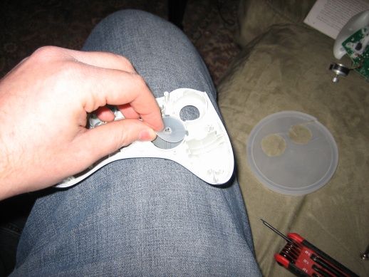

    2. The addition of a piece of plastic added to the underside of the D-Pad in between the membrane and the plastic underside of the D-Pad. You can use thicker plastic for a snappier response or skip this if you prefer the softer feel of the stock D-Pad.

    On two controllers I use the simple plastic washer fix as shown -- cut from a lid. There's some debate if enlarging the hole is necessary. It's worth suggesting just try the washer first to see if that's enough for your unit / taste.

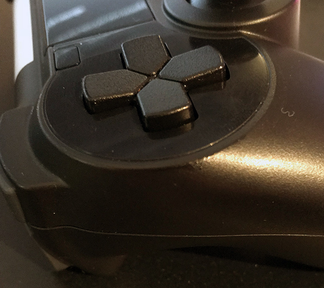

    I think the best d-pad is from the PS4 proto controller:
  18. Pinta77
    Pinta77 Gamecube Fanatic
    Feb 27, 2018
    57
    That looks pretty comfortable.
  19. Gilboa
    Gilboa Member
    Feb 26, 2018
    Wow that's the first I've seen of that. It looks like it would be an awesome SNES style d-pad. Too bad they stuck with the more traditional design.
  20. Borman
    It basically feels like a Vita D-pad, which is also great
