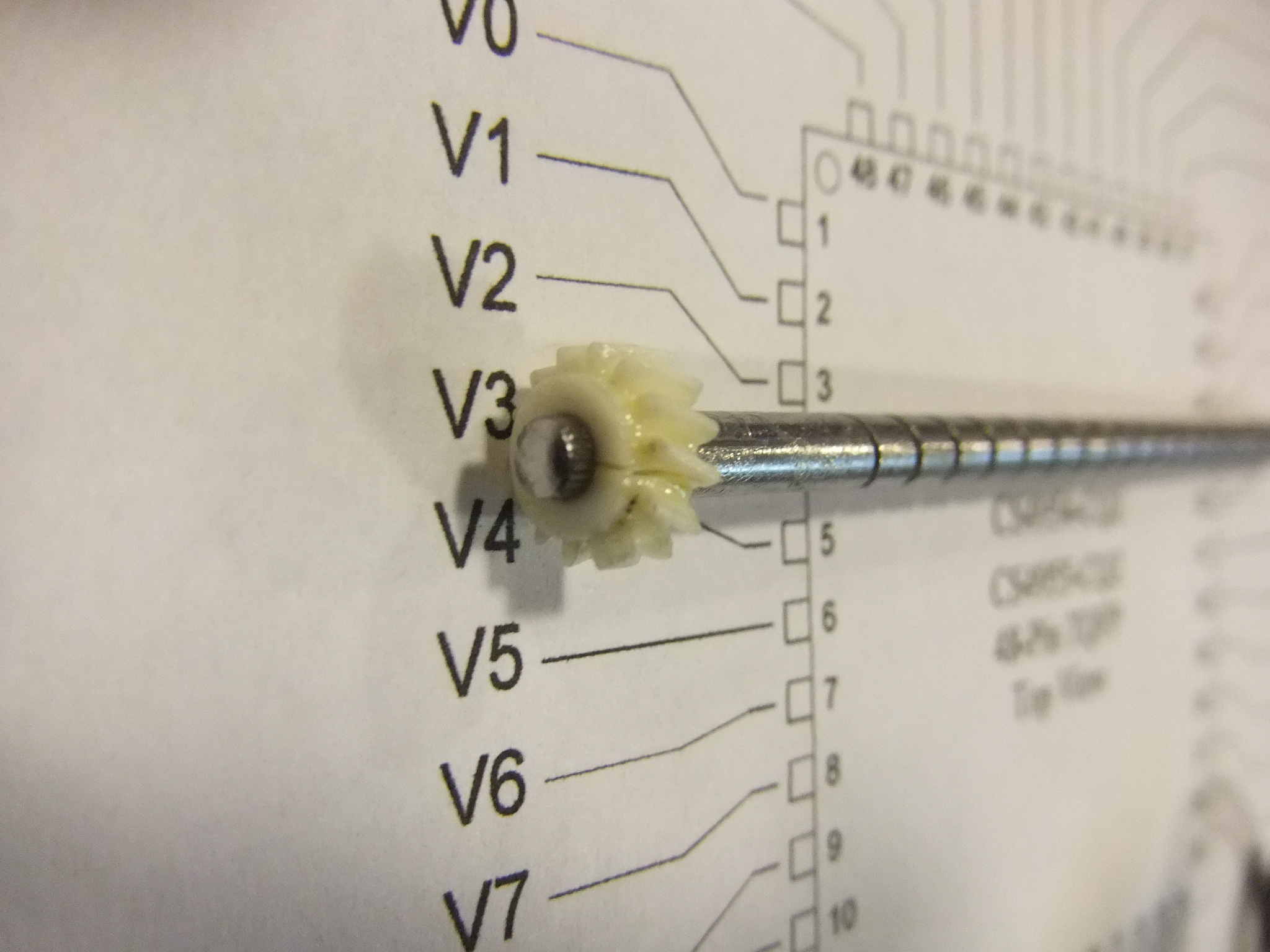

    the plastic gear at the end is split making it a little wider on the split half.
    as the drive spins it will get hung up at that revolution.
    i tried to loosen the bracket that holds the motor then it does not grip the gear good enough, too tight and it locks the drive shaft per the revolution.
    its time to replace it.
    anyone have a dead fz1 cd drive. i don't need a working laser.
    let me know I'll buy it from you .

    Fixed! :)
    with a gear from a Sony CDU-8002 mechanism inside an AppleCD-150.
    A guy at a local pc store gave me some old cd roms from 1992-1997.
    http://www.performance-gear.com/images/proto.JPG
    the gear looked like the lower gear in the above pic.
    i removed the center part and cut that in half so i got 2 replacement gears out of it.
    I then used a small screw driver to gouge the hole in a few spots.
    now the shaft fits snug with no glue.
    The 3do is working great
