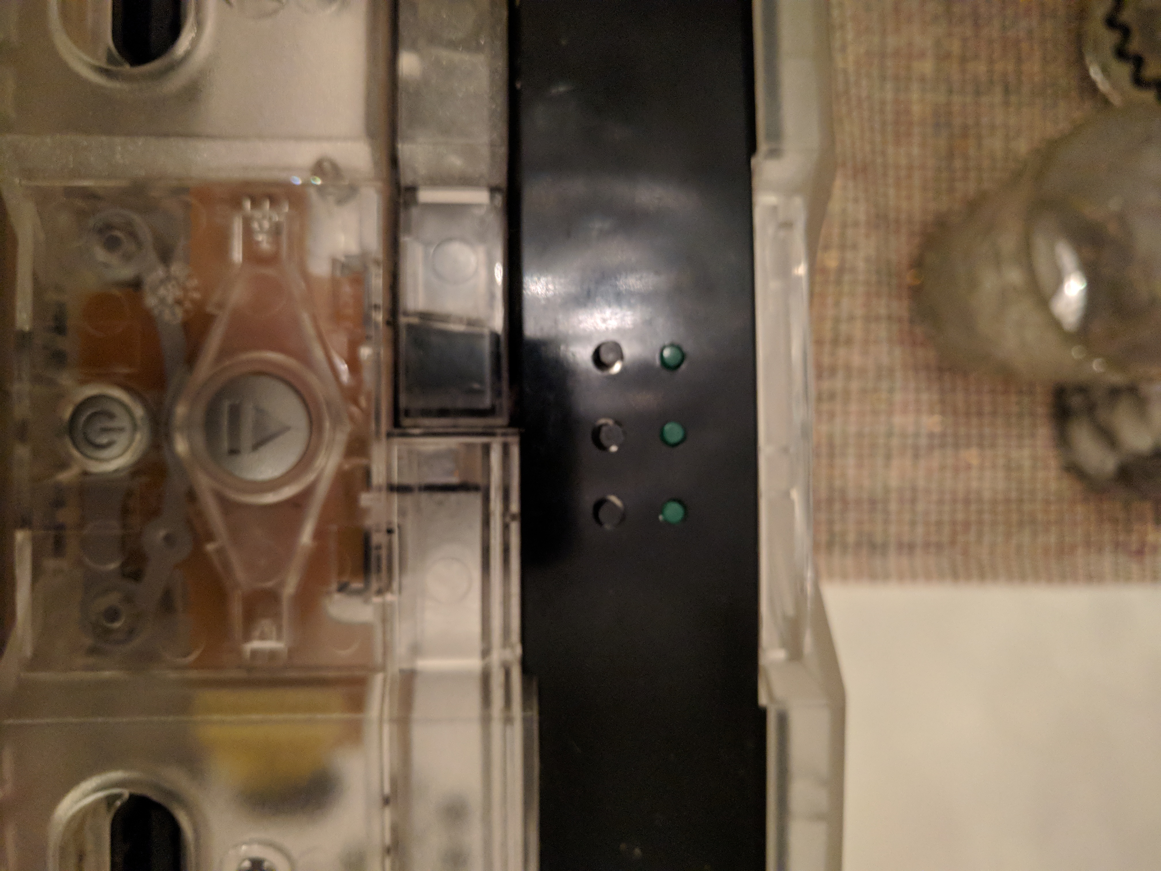

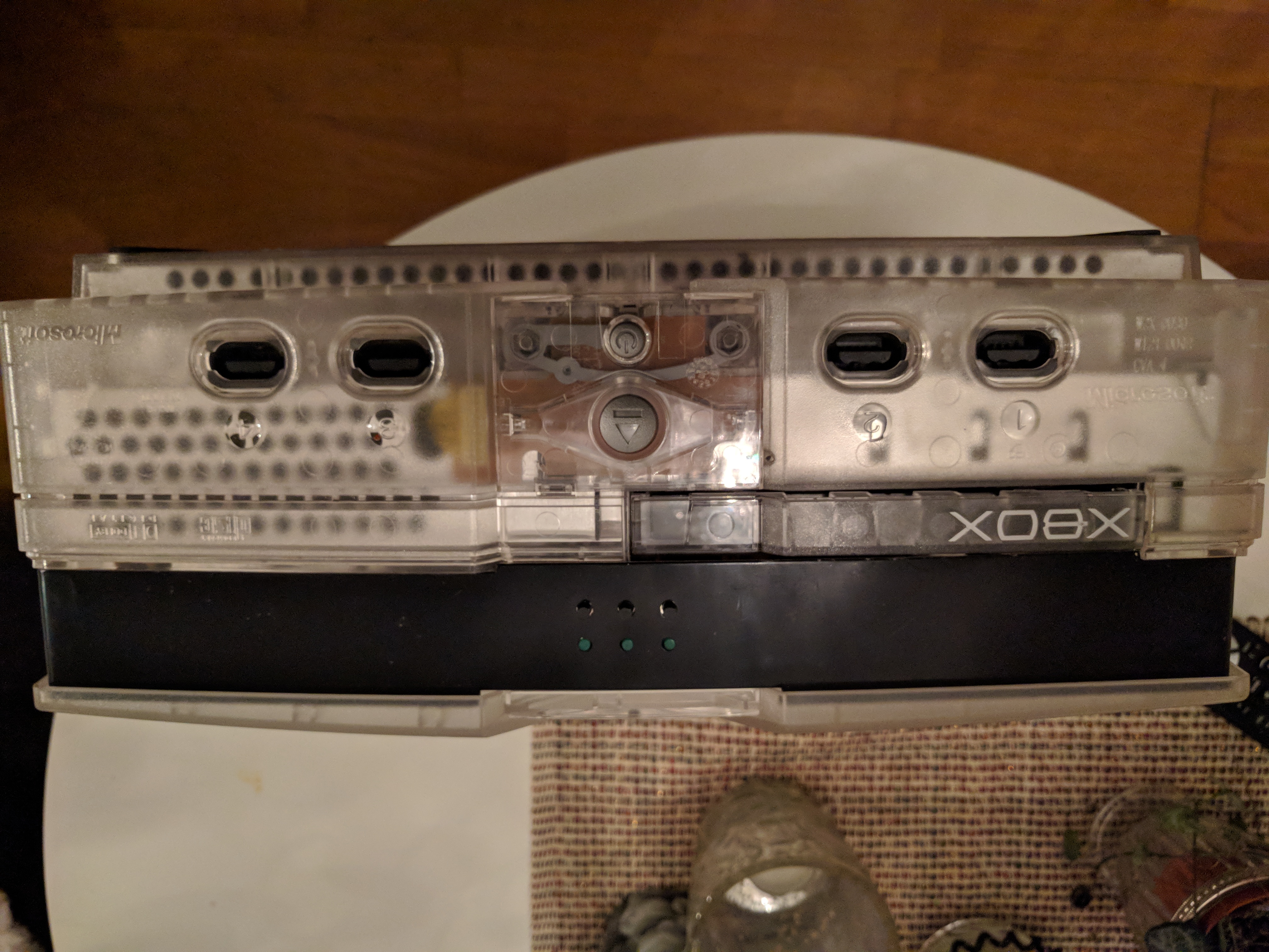

    Found this odd Xbox at a yard sale today.
    It looks modded and is massive, even for an original Xbox.
    Notice the 3 buttons with corresponding LEDs.
    Looking at the datecode, serial and manufacturing date it seems to be a crystal case limited edition.

    I'm gonna go on a limb and say it's modded.
    When you press the buttons, do they do anything?
    MobCat likes this.
  3. Bad_Ad84
    1,308
    I'm guessing multiple hdd mod and buttons switch the drive
    DeChief, MobCat and Flaya like this.
  4. Borman
    It is an X-Tender, basically a device that lets you switch between multiple harddrives.

    Basically pointless with a 2tb drive installed.
    Didn't realise the xtender looked so terrible.
    I'd sell to a collector (or keep, if you are a collector) and just use a 2tb drive if you need lots of space.
