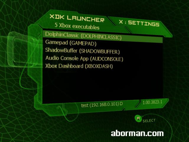

    Looks like a DVT3 to me, based on the MCP X2 chip (confirmed it with old pictures that I have)
    I believe the last XDK you can run is 3823, as that is what mine was running (though at one point I had an older build disk, dont have it anymore).

    3823 hmm....i probably dont have such old xdk :( Oh well, lets try to find it.
