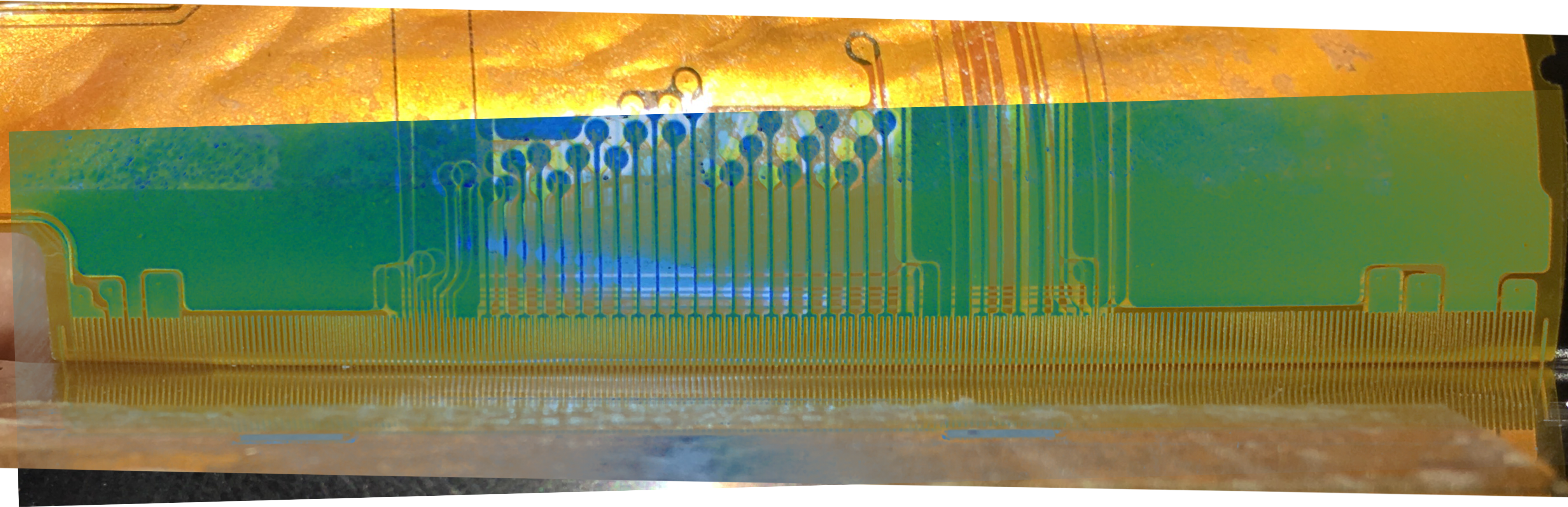

    I've got a nitro capture with a broken screen.
    i try to replace screen & shell.
    but, when i turn on, i have screen bellow.
    when i put old screen, everything is ok !
    i've checked the old & new screens and they are "same".
    [GALLERY=media, 1596]Nitro capture screen by code1038 posted Sep 24, 2016 at 1:42 PM[/GALLERY][GALLERY=media, 1597]Nitro capture screen by code1038 posted Sep 24, 2016 at 1:42 PM[/GALLERY]

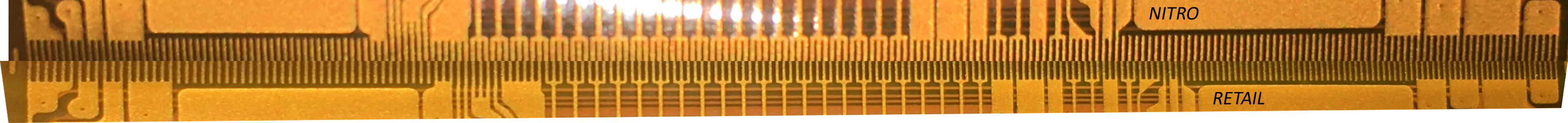

    Finally, i found it ! (& broken a second screen ! yeah)
    it's not good :(
    upside : NITRO screen
    bellow : RETAIL screen
  4. Borman
    Assuming your Nitro has a DS Lite addon, maybe try looking at the late model original DS screens? Those had brighter screens than the launch models, perhaps they used a different revision? Not familiar with DS stuff really.
