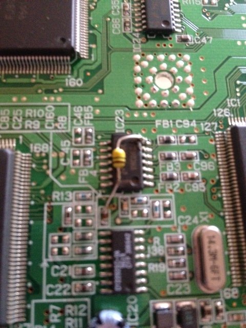

    Recently bought a Jap Saturn which has no Video or Sound upon boot so after trying different leads I thought I'd delve inside and see if there was anything obvious.
    I've attached a picture of what looks to be some non manufactured soldering around IC23 but that's about where my skills end. Does anyone have any idea what/why this is there and would it be safe to remove?
    The saturn powers up fine, disc spins just no image or sound. I've tried a different powerboard that I know to be working fine and that does the same too.
    Any help appreciated!

    I think it's probably an extra decoupling cap soldered across the power pins on the clock buffer. It's hard to see from the photo, but one end is going to pin 7 and the other appears to be connected to a trace going to pin 14 - and they are the power pins on the chip. My guess is that it was installed to reduce noise on the clock signals.
    I can't see removing it would cause any problems, but I dont expect it would help, either.
