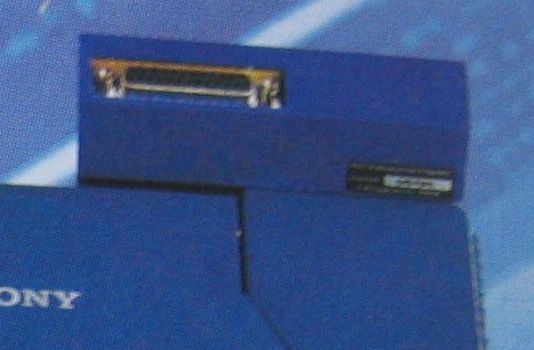

    Closer shot of the cart

    I'll have to check, but I thought that the 25pin connector on the Psy-Q I have is parallel. While that picture indicates it's SCSI. Interesting, I need to disassemble the I/O code on those carts at some point.

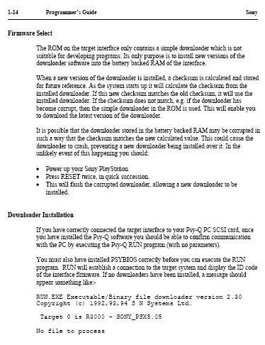

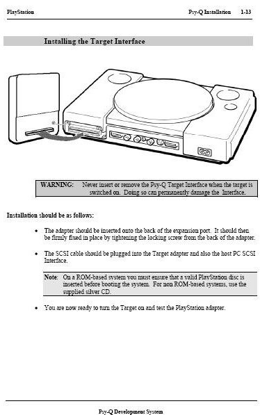

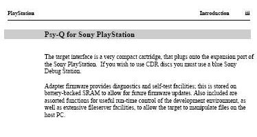

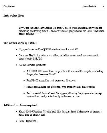

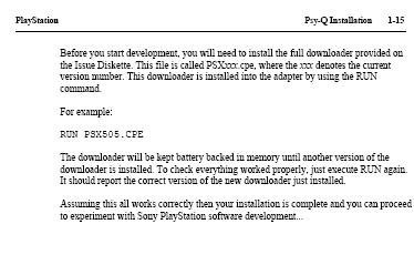

    I have the psy-q manual (pdf version) from 1996.
  12. Twilight
    Twilight Site Supporter 2015
    Dec 7, 2007
    615
  13. unclejun
    Nov 12, 2005
    1,912
    120
    The Psy-Q manual or the one you already have?

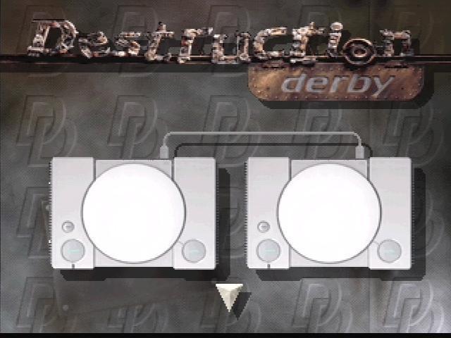

    The serial port allowed multiple consoles to be connected for multiplayer or for connecting a console to debugging software.
    Never heard about using the serial port por multiplayer.
  15. l_oliveira
    l_oliveira Officer at Arms
    Nov 24, 2007
    3,879
    245

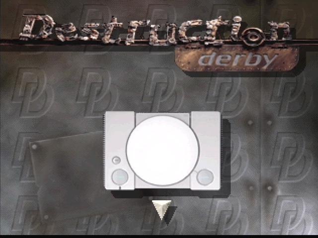

    Destruction Derby. A fine game published by Psygnosis in 1995.
  16. unclejun
    Nov 12, 2005
    1,912
    120
    Every multiplayer games without splitscreen option offers serial link connection.
