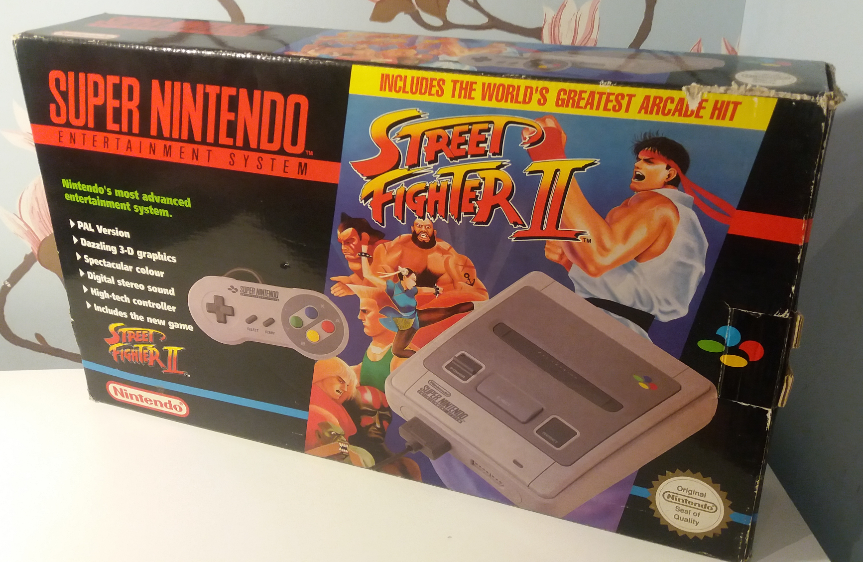

    I've found some more Super Nintendo's, in the loft this time though, which is good because it's dryer! I think this ones gonna be another 3-Chip though, as it's very yellow and it's the SFII release, which was pretty early. I can also see the 3 dots inside the expansion port, which apparently also makes it likely 3-Chip. I'll only know for sure when I get home, as the right screwdriver is there. Boxed though! sfiisnespal01.png
    Is there a chance at all that any 1992 Super Nintendo's are 1-Chip?

    No. 1 chips weren't released until 95.
