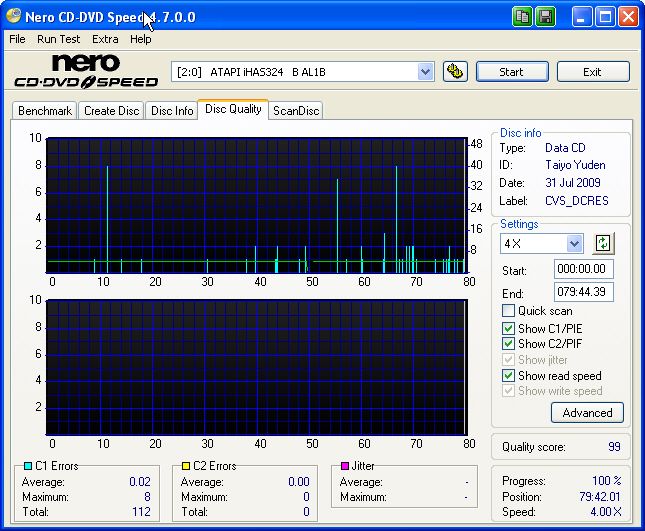

    Is there a way of testing for errors then?
  19. s8n
    s8n Enthusiastic Member
    Dec 10, 2011
    524
    74
    yes check the pic below of a Dreamcast game i did , also not all burners can ' scan ' tho. Some will give a inaccurate result , if you want to see if your burner can give accurate results go to ClubMyCE forums and ask there.
    To find the sweet spot for CD-R's i burned the same game at X12 then X16 then X24 and scanned each disc , X16 gave the least C2 errors which are the nasty ones.
