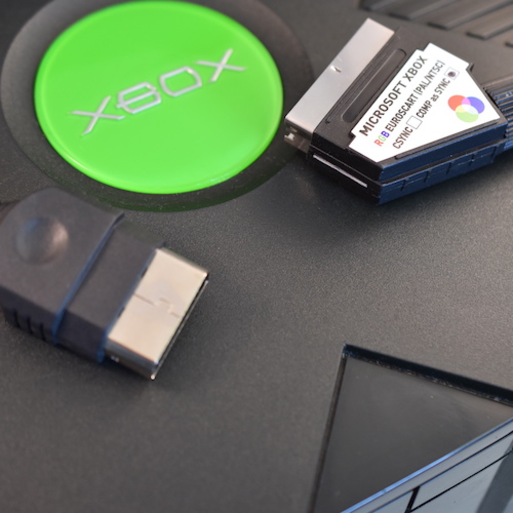

    Will the SCART cables output in 480p, 720p and 1080i? Also, is there a difference between the official SCART cables vs. the cables that Retro Gaming Cables sell?

    Scart doesn't officially do 480p+ as a standard. So the Xbox doesn't either. Component is the way to go on the Xbox.

    At one time I had both the box and the cables. I personally felt the video looked better with the box, so I kept it and sold the cables. As mentioned the SCART is pointless because it won't do 480p.

    If I were to use an NA Original Xbox, can you force Enigmah to show at least 480p through the SCART cables? If so, would the signal be interpreted as Sync-on-Green (RGsB) or Y/Pb/Pr?
    The reason I ask is because I have an OSSC and I can use progressive scan with my PS2 through SCART, and was wondering if I can do the same with the original xbox.
  15. citrus3000psi
    Nov 8, 2013
    1,051
    418
    Not sure what cables you have to work with, but the OSSC does accept YPbPr through the scart connector. So you could build a custom cable.
