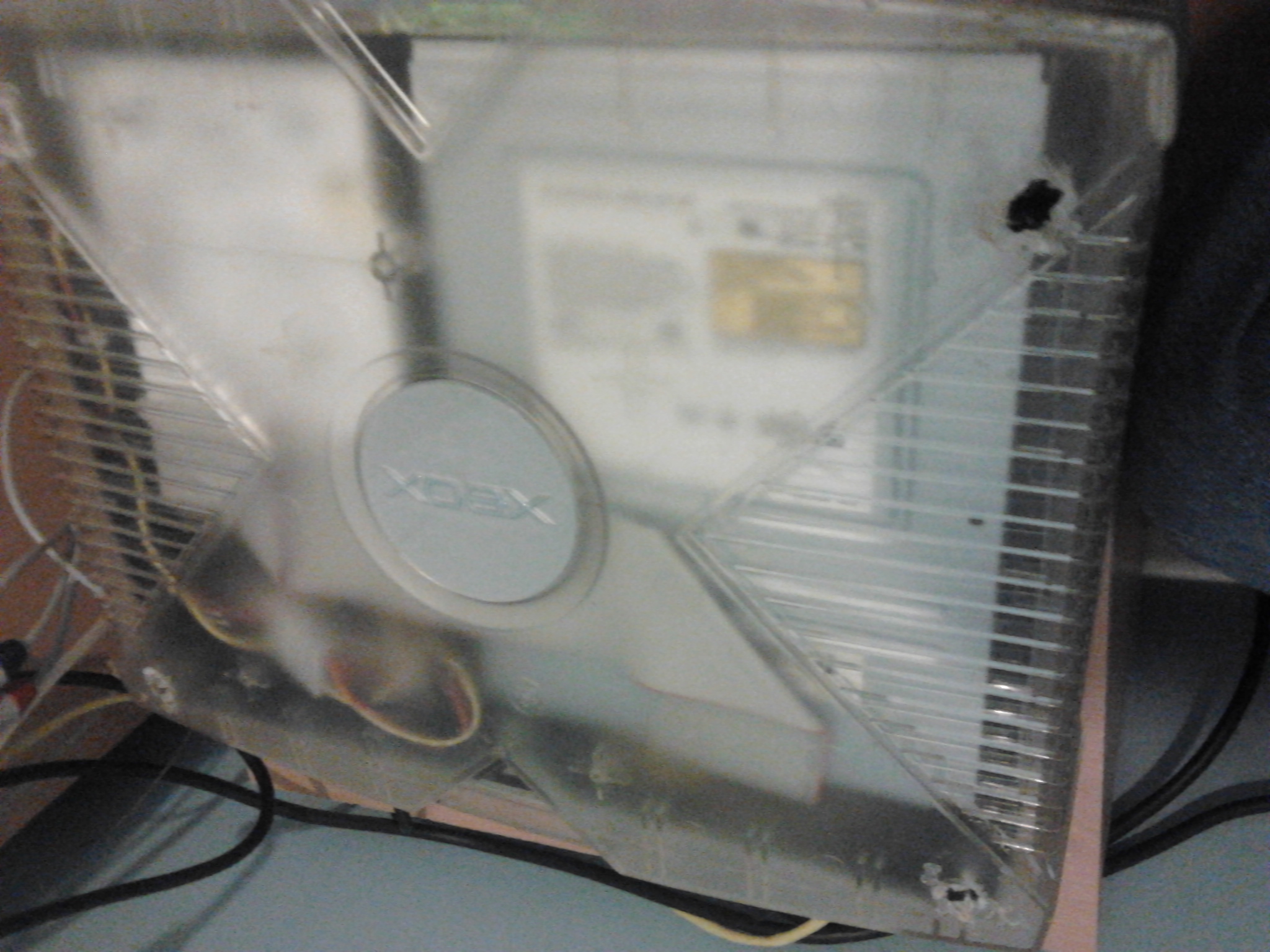

    yea well ive got the console open the case isnt too badly damaged but doesnt bother me(all it needs now is a bigger hdd and it will make a sweet media centre) IMG_20130801_001935.jpg
