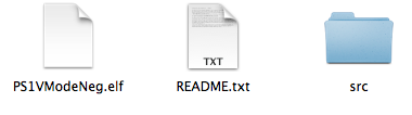

    okay, so i dont know what i did wrong, but heres EXACTLY what i did so you guys can help me :)
    I formatted my usb to FAT32 and pasted this file to it.
    when opened it shows these files
    and i copied this file
    to a 4.7gb dvd-r and burned it.
    when i pust the disc in my ps2 it says there was an error or something like that.
    what do thread?
    what do?

    That is because it is a CD-R image and not DVD-R, as the PS2 has media checks. Burn it to a decent branded CD-R instead, boot the disc and load the "ELF" from USB via the "Mass" option in UlaunchELF. You should not have any problems doing this and if anything happens with the disc, etc, would be you're side, as this works !00%.
    Btw, only have the ELF file in the root of the USB, don't have it in a folder, as it should be on its own.

    ok cool. so the src file shouldnt be there either?

    i'll tell you EXACTLY what i did.
    I copied this file to a blank vertabim Cd-r 700mb:
    and when i put the disc in my DTL-30002 PAL, driver version (1.10) browser version (1.20) CD player (1.20), it doesnt do anything.
    i waited a good 20 seconds and nothing happened sadly.
    And i have this file on my Usb formatted to FAT32 for reference:
    any help guys? :)

    Its a bit vague when you say copied the file to a CD-R. It would be either be a data disc with the file copied (burned) and accessible (file only i.e "bin" file) or the actually bin file burned, as a standard image and when accessed via the computer the contents of the file are shown. The bin file needs to be burned like you would with any type of PS1 game backup. Imgburn is used on a PC to burn them.
    I believe you are a MAC user to which I cannot help you with, as I use a PC and I don't know what MAC users use for burning discs. Like I mentioned in my posts, if any issues arise with burning the disc, etc, would be your'e side. This has been tested by myself and is 100% fail proof. It could be the laser on the PS2 (does it work well with other discs?) poor media, burning program?
    There is nothing else I can help with, as I have explained what is needed to do, as there is nothing more to add or to explain on how to burn the image and booting the ELF from USB. All the information is here in the thread and I suggest you see a friend or someone with PC who can help, if no luck with a MAC computer.

    Mac has a cd burner built into the OS.
    thats what i used.
    So i have to burn it as a disc image?
    and it cant be my ps2. i got it boxed new 3 months back :)

    FUCK YES I GOT ULAUNCHELF WORKING ON MY MAC!!!
    WHAT DO I DO NOW!!! D::D:D:D:D::D :D:D:D: D: D:D: :D :D
  12. LukeLexeme
    LukeLexeme <B>Site Supporter 2013</B>
    May 23, 2013
    380
  13. Shendo
    Shendo Rapidly Rising Member
    Aug 2, 2008
    77
    Start uLaunchELF.
    Connect USB stick to PS2.
    Insert FF VII.
    Go to mass: and run PS1VModeNeg.elf.
    Profit.
