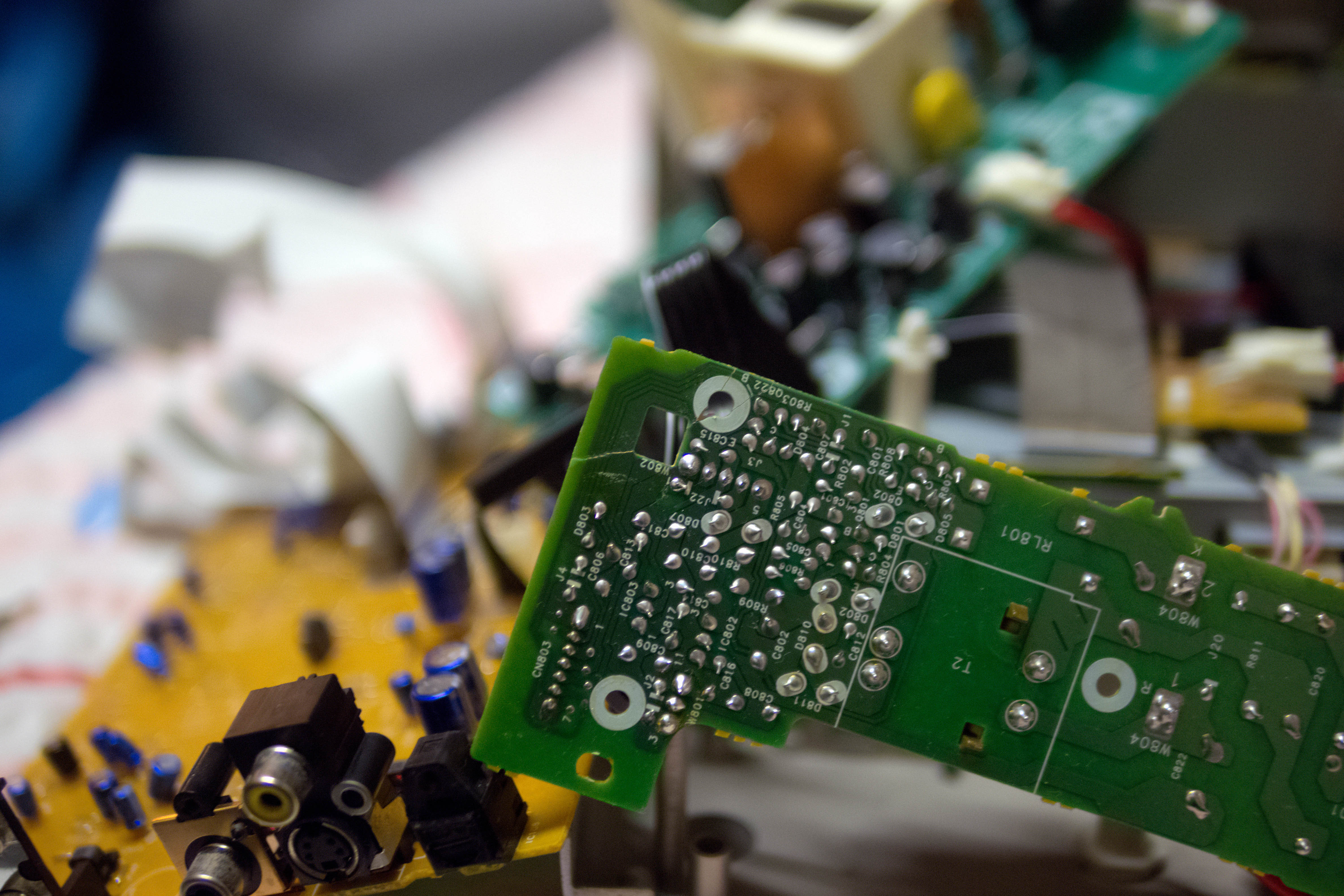

    I finally took the time out to disassemble the Panasonic GameCube much more further in to inspect the boards properly.
    I was worried that I would not be able to identify any problems on what could be causing for it not to power up, even fearing that the difficulty in taking all the parts apart would've caused more damage than what would initially existed. And then I came across this:

    That is the same problem I described above. You see the traces on the outer edge of that square hole and the obvious cracks? Simply trace where the traces go and solder some wires to make a connection where the broken traces would go.

    Any standard wires like 26awg is fine, if you reinforce the board and glue it in the back you could scrape the traces and put a bead of solder across the crack. Wires are a safer bet but you atleast have options.
