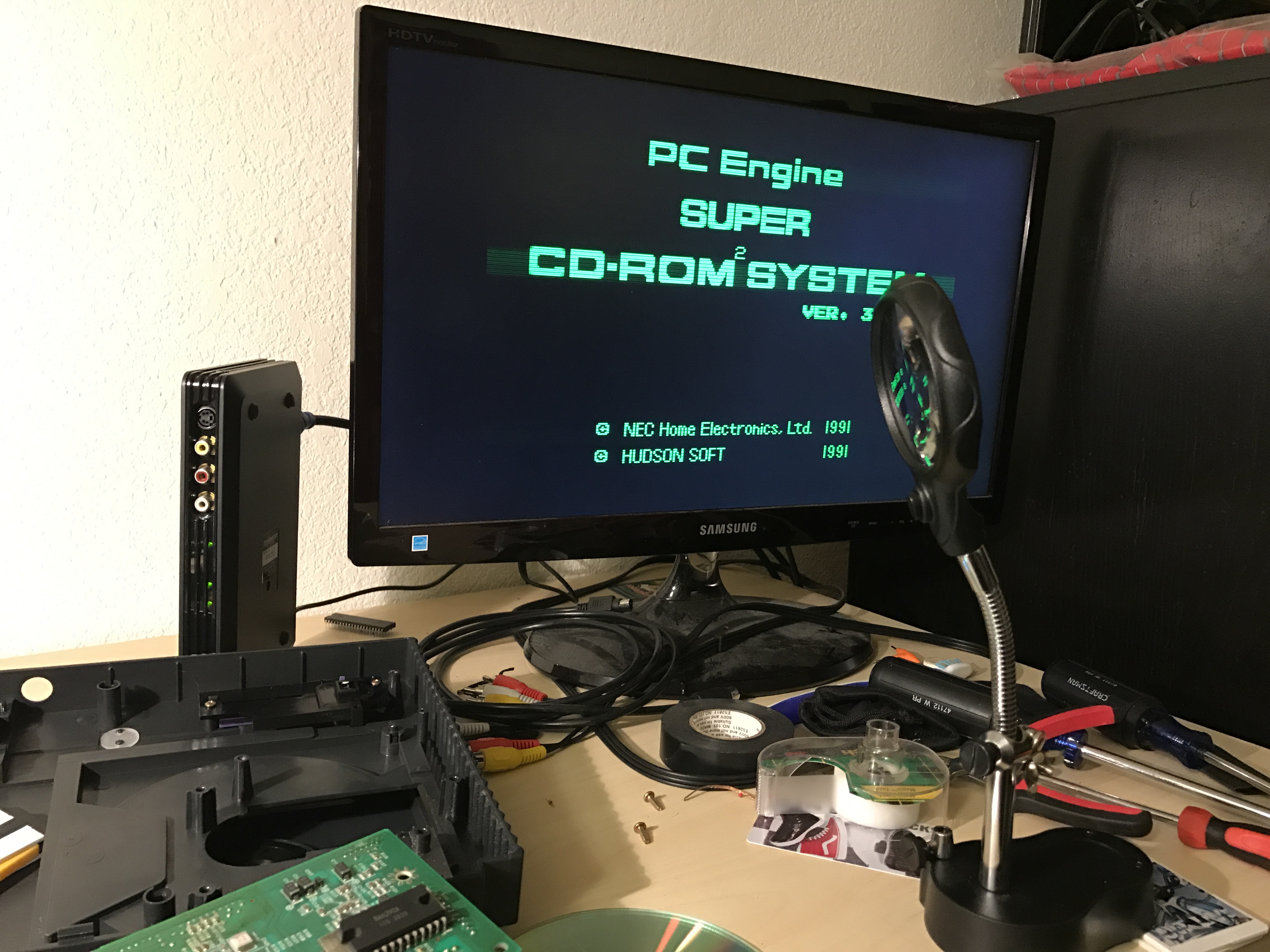

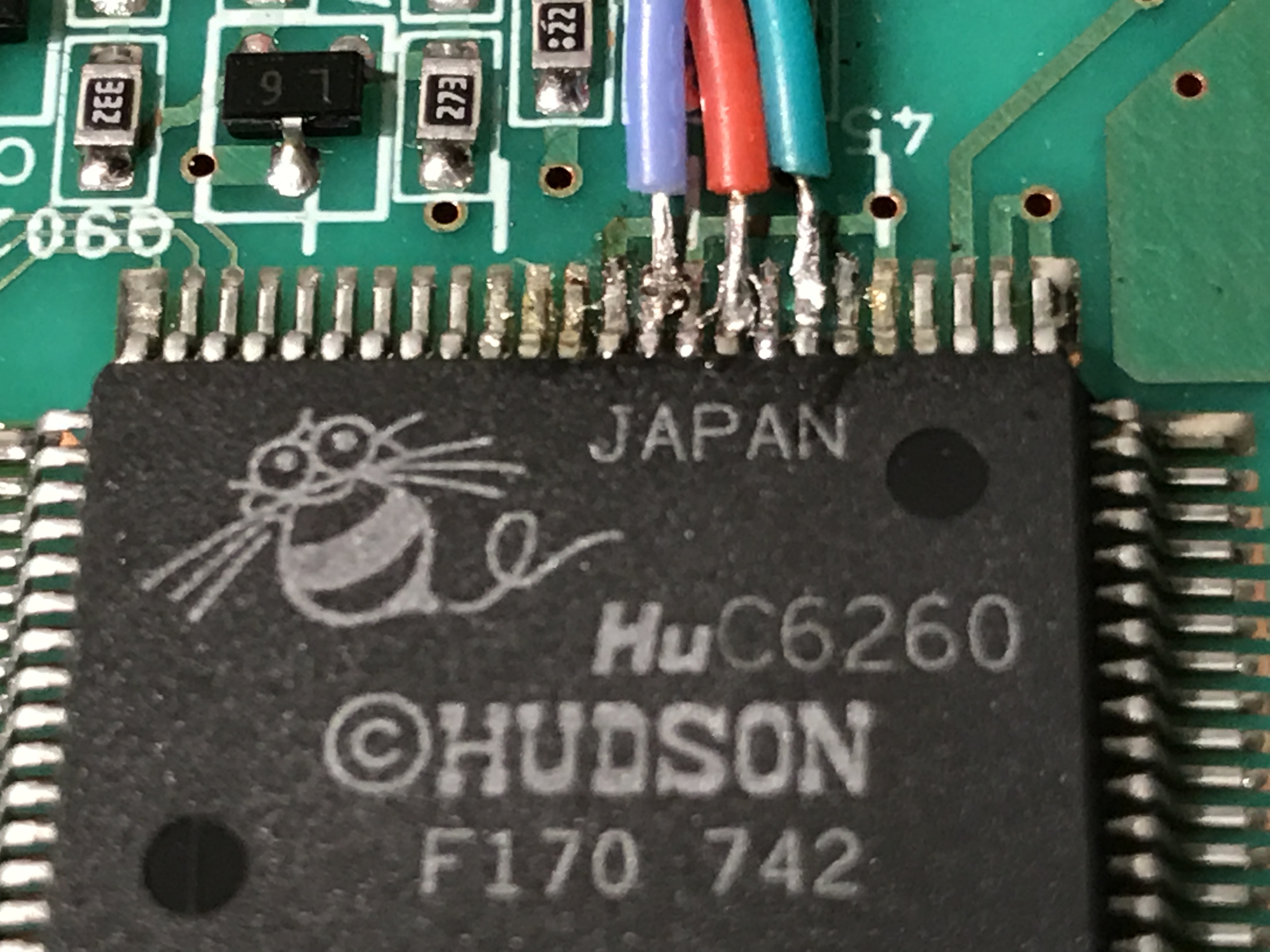

    IMG_1515.JPG So I believe I have everything hooked up to the RGB amp I bought from Mickcris (8 pin DIN and amp) and I'm getting video output, but only one color.
    The wires look like they are all securely and correctly soldered to the 6260, but.. Nada. If I desolder the red or the blue, I still get video output, but it's fuzzy and green. Solder them back and it's a clear green picture.
    I checked with a magnifying glass to make sure there are no bridges (a zoomed in iPhone photo looks like there's one on blue, but it's not actually touching the neighbor pin), but it doesn't look like there is.
    Using 30AWG wire in case that matters.

    Despite what you said about bridging, perhaps you could try to make your red and blue wires look more like your green one on the C6260? Check your continuity between pins with a multimeter. Check Red to ground and blue to ground.
    You could also try to do one at a time. Desolder blue. Resolder red. Check all connections (chip to amp, amp to plug, wire to plug, etc).

    There a definitely solder bridges in that picture.
    If you find it too hard to solder to the IC pins, maybe you can find easier spots elsewhere?

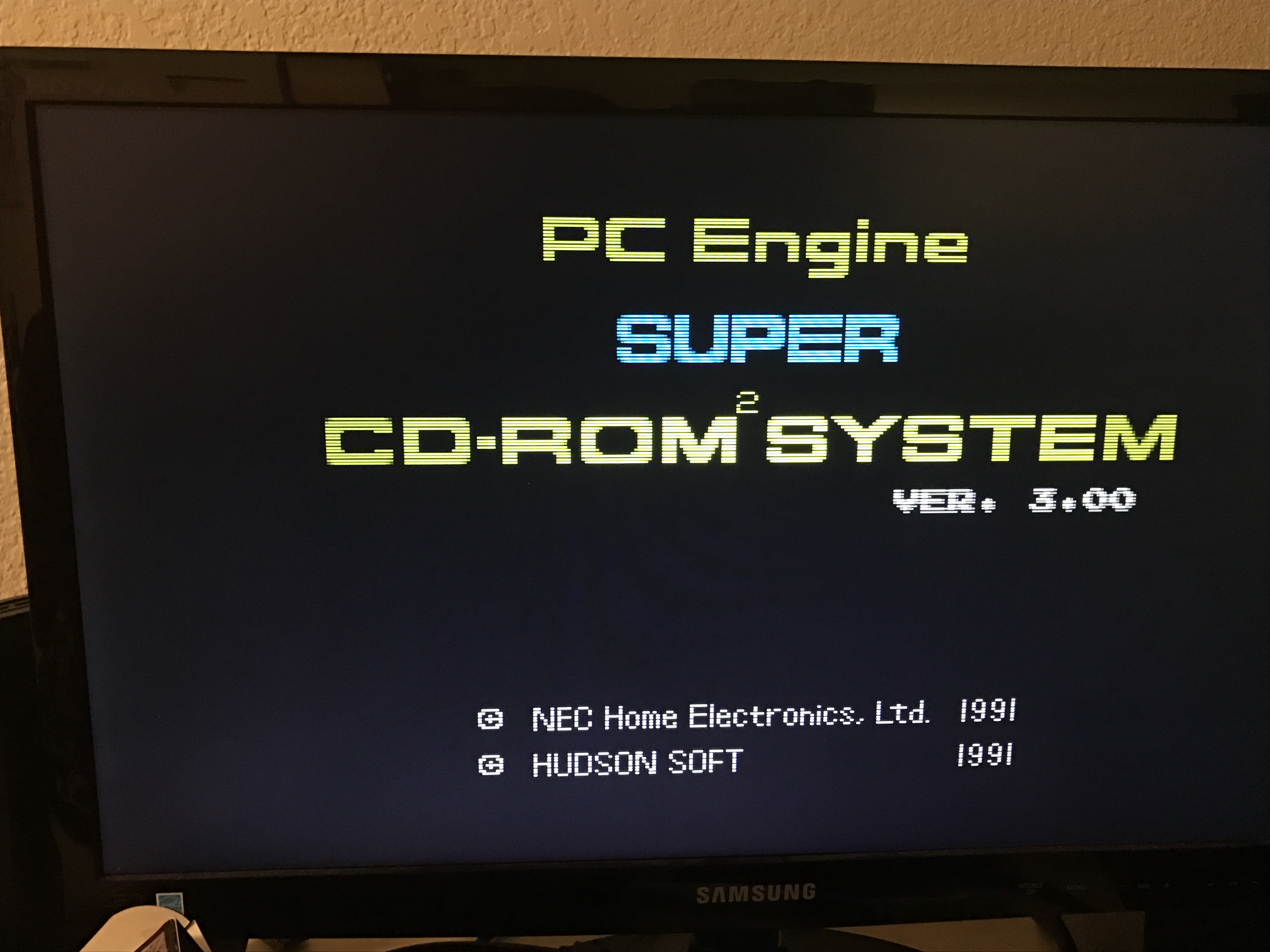

    IMG_1519.JPG Yeah, I had to look again. I took everyone's advice and just did the solder job over again.
    Success!

    Yeah that photo you posted I can see the red is bridged on the pins on both sides and blue looks like it might be bridged on one side too
  10. digitalia
    digitalia I will take the bullet for this one...
    Dec 25, 2015
    57
    Yeah, but up close it didn't look like it (and it was my fourth time resoldering these. First time I was getting an all red picture!), so I just made the assumption that it wasn't it. Alas... I did a dumb.

    If you are not sure nothing beats a multimeter, set it to continuity and just check the adjoining pins. It will take you a minute to check all three wires :)

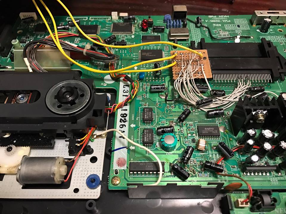

    Yeah, that region mod prevents the hu-card from being read 9 out of 10 times and it looks like he wired the power switch directly to the breadboard (and I have no idea where the switch is soldered to on the board).
    I ordered the region mod board from GameTech-US to replace the breadboard. He glued the PCB to the Hu-Card slot right over one of the screws I needed to remove, so I gently snapped the board off.

    On my pic where you can see the breadboard, you see those three thick yellow wires? Those are wired directly to a ON-OFF switch on the back. I've never owned a PC engine (duo or otherwise, only a TG-16 as a kid), so I assumed it system with a toggle power on the back and on the front, kind of like a PlayStation 2/3/4.
  20. voultar
    voultar Rapidly Rising Member
    Sep 4, 2013
    76
    60
    That On/On switch doesn't control power to the system.
    If the switch is in one position, it ties the output selection pin on the multiplexer high making the databus go D0,D1,D2,D3,D4,D5,D6,D7. If the switch is in the other position, it ties the selection pin on the multiplexer low which inverts the data bus to D7,D6,D5,D4,D3,D2,D1,D0. This is what region protection (for the most part is) for the PC-E and TG16. They simply inverted the databus pins on the Hu-Card slot for the US systems.
