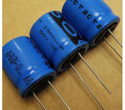

    Also check PSU for leaky capacitors. Often the light blue Philips ones will leak, especially on something as old as this.
