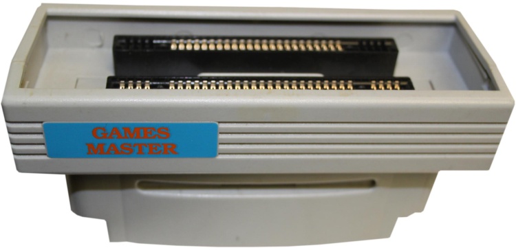

    That adapter (2nd link) will work for most games. That adapter just routes the CIC connections to one cart and the rest of the signals to another. He could absolutely use this for playing US games on his SFC as long as the NTSC cart will fit in the sockets or he is willing to cut any plastic in the way on the adapter. He will have to plug a NTSC cart into the slot that it gets its CIC from.
  9. Bad_Ad84
    1,309
    Yes, but the cart slot is same shape and the adapters just pass through. You put an NTSC game in the front and a PAL game in the back (for the CIC). So to do what the op wants, just put an american game in the front and any NTSC game in the back (for the cic). You could even open it up and make it so you only need the front cart if you really wanted, by soldering the connections that go to the back cart back to the front cart slot.
    So yes, the linked items will work just fine.
    I also own the first one and can confirm its fully wired.
    americandad likes this.

    The second one is indeed a US SNES to SFC adapter.
    The first one is a US to PAL converter and since the pal and sfc carts are of the same shape I'm thinking it might work. Unless it outputs a pal cic code.

  12. Bad_Ad84
    1,309
    No, the description doesnt say that at all....
    It has 2 cart slots on the top, front one has all connections except for CIC wired to the slot -> console
    Second slot has just CIC pins wired to console. You put region of console you own into the back slot and import into the front slot.

    According to Bad Ad and to the attached picture it doesnt have it's own cic chip. It uses whichever cart you put in the back of it to output that carts cic code.
    Kind of like the action replays on the psx that used disc swapping to trick the psx.
