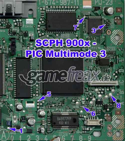

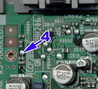

    The problem you are having is very common with the original OLD CROW hex, if it was a MM3 you shouldn't have that problem
    here are the install diagrams for it
    900X

    Nope. My diagram did not look like that at all.

    He knows what the MM3 install looks like. He is saying the problem you are having is common if your chip has the old crow hex on it. Considering you have no idea what you bought, then you cant really say he is wrong.
