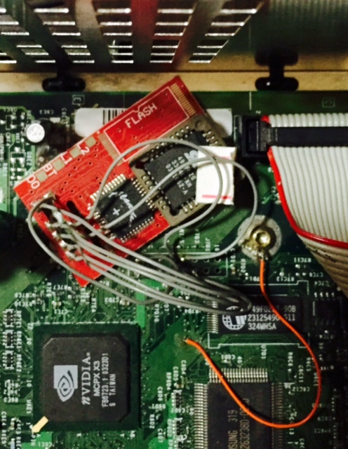

    Thanks for the info! gives me a little hope. To be honest, i'm not sure what i saw. I did some searches online for chips and was swimming in information..lol. Way to much to process and straighten out for a mediocre modder like myself. This is the chip I have currently FYI. It's got to be from 2003 since that's when I visited UAE.
  7. APE
    That is a wire install instead of using pin headers for the LPC bus. I wouldn't do it just because the pin headers are a solid solution and that can bounce around. Without checking I'm 99% sure that orange wire is just there to ground d0 to force a boot from the modchip. There is a secondary d0 point on the underside of these boards that is larger than the one on top, much better to shoot for it instead of the top for inexperienced installers.
