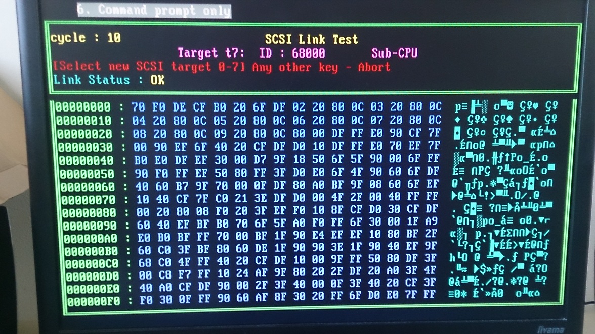

    The magic settings were L1 and L2 cache, hidden away in an "Advanced Settings" menu I hadn't noticed before. Unfortunately disabling them makes the machine dog slow, so Windows 95 is completely out of the question, but I'm very much at home with a command prompt so it'll do for now.
    I've had a thorough play around, here's what I've figured out how to do so far:
    • View and test both the Main CPU and Sub CPU with SNTEST.EXE
    • Upload a new BIOS file with MEGARUN.EXE (seems to have the SCSI IDs hard coded to 5 (main CPU) and 7 (sub CPU) which is annoying)
    • View both CPUs in the debugger, start and stop them, and view memory and registers
    • Create an empty MegaCD IMG file
    • Write content to the IMG, and stick a binary in the header
    • Start the SNSERVER and load an IMG into a disc slot
    • Build 68k code with SNASM68K.EXE with debug info that the debugger picks up (SOURCE LEVEL DEBUGGING OH MY GOD!)
    Unfortunately trying to upload my built ROM file and unpausing the CPU results in "SCSI ERROR" and the system halts. I'll have another play around tonight and see if I can figure out what's wrong. The manual is pretty thick and I skim read it, so it's likely I'm missing some basics steps.
