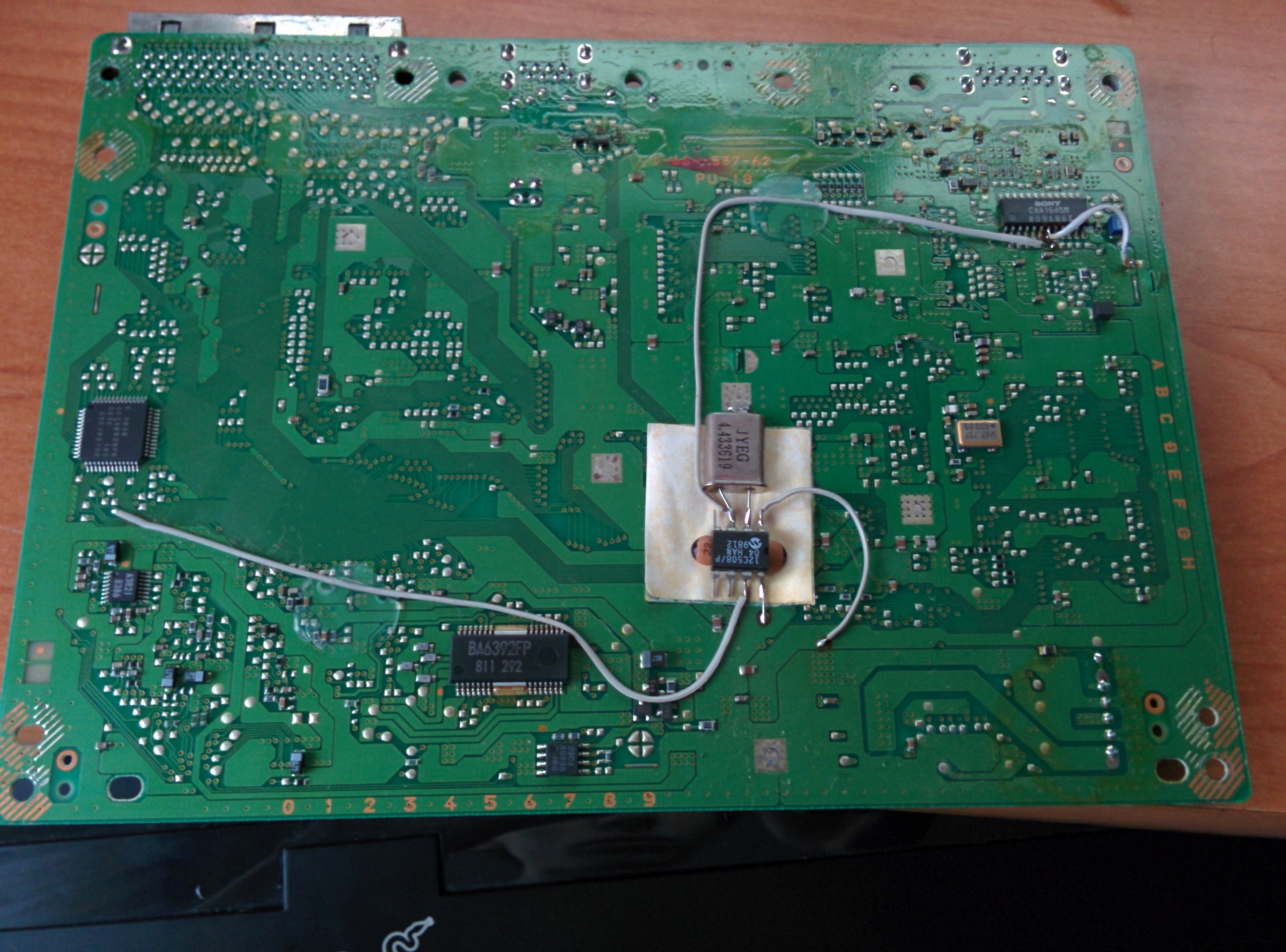

    I've adjusted the laser pot, but i am getting the same results.

    What a shit install, sems the modder used a lighter to solder :p ....
    And why use an oscillator when you can use one directly from the motherboard...

    You think that's bad soldering... :/
    I certainly wouldn't post a picture of mine lol (works perfect though)

    Doesn't look that bad to me.
    Sounds more like crappy discs+crappy burner. PS1s are notorious for not liking discs, pick up a Plextor from 2003 and a pack of Taiyo Yudens.

    Some point seems burned, but the worst thing i see it's with the chip on the top right corner :S

    Because the mod is doing two things - it's providing a data stream for the CD controller (on pin 7, by the look of it) - and it's also generating a 4.43 MHz clock for the video encoder. On the PU-18, you need to add an additional clock if you want to have the console output correct colour in both NTSC and PAL modes. It looks like he's cut the NTSC/PAL input on the video encoder and wired it to ground to force the chip to always be in PAL mode, and then cut the trace carrying the subcarrier output from the GPU and fed in an external 4.43MHz clock - that way, the console will produce PAL in PAL mode and PAL-60 in NTSC mode.
    Oh, and incidentally, none of the connections are burned - that's just what 10 year old flux looks like.
