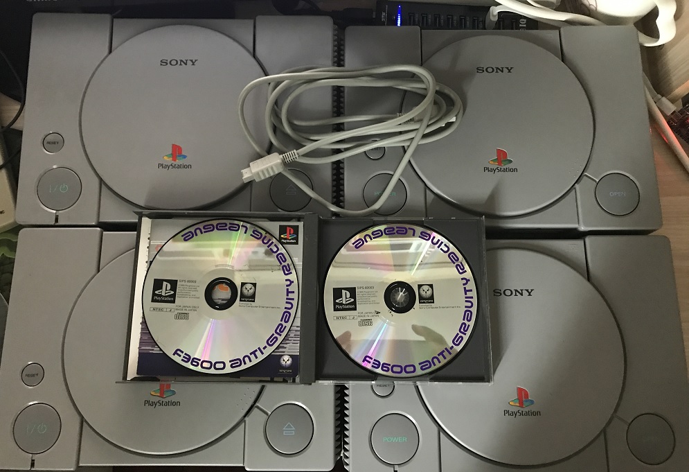

    Edit:
    OK, I just tested this, and it appears that Wipeout is highly sensitive to frame rate errors.
    This was done using the NTSC:J version of Wipeout (SIPS 60003)
    SCPH-9003 (no mods) <-> SCPH-7000 (no mods) - works, as expected
    Baseline test
    SCPH-9003 (no mods) <-> SCPH-7000 (with modchip) - works
    Same console as test 1, but with a modchip installed. No change.
    SCPH-9003 (no mods) <-> SCPH-9002 (with modchip) - connects, but then fails with "Link terminated".
    SCPH-9003 (no mods) <-> SCPH-5502 (with modchip and dual oscillator) - works
    The dual oscillator mod allows the console to generate correct frame rates in 60Hz mode, and this configuration works - despite the PAL boot ROM in this console.
    I then modified the SCPH-5502 to bypass the NTSC oscillator and run both GPU inputs from the PAL one (basically, returning it to stock) - at this point, the game started producing the "Link terminated" message, just like the 9002.
    Conclusion: Wipeout can't even tolerate even an about 1% error on the frame rate, and loses sync.

    OK, I wouldn't be in a hurry to get a SCPH-5502 - the reason it worked isn't because of the model, but because I had modified that specific console so that it contained both the original 53.203MHz PAL reference oscillator and a 53.693MHz NTSC one. As a result, when it's switched over to NTSC mode then it runs at exactly the same speed as a NTSC console rather than with the slight error I mentioned earlier.
    This was enough to make it work - also note that I was doing testing with 2 identical copies of the game, both NTSC:J - I suspect that a PAL and NTSC version might not be able to sync at ll.
