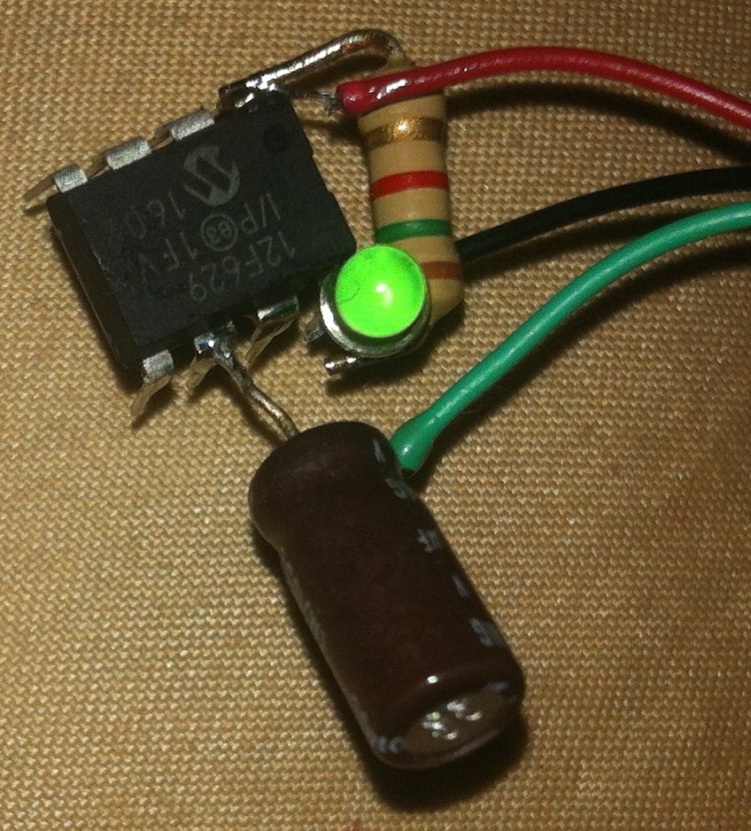

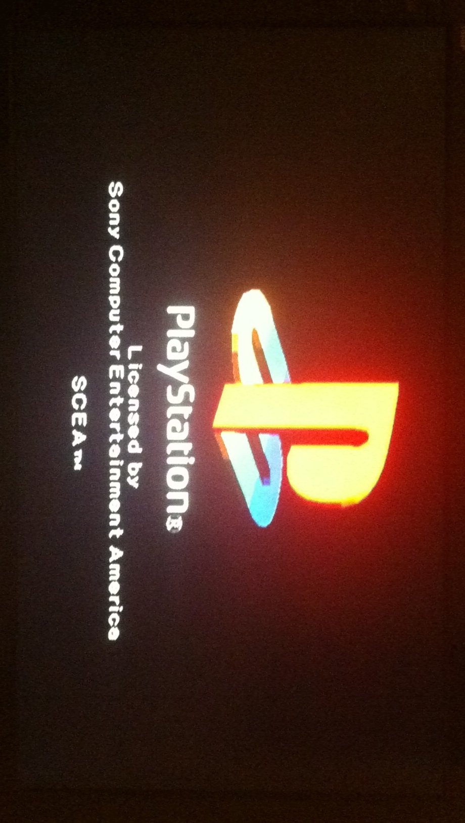

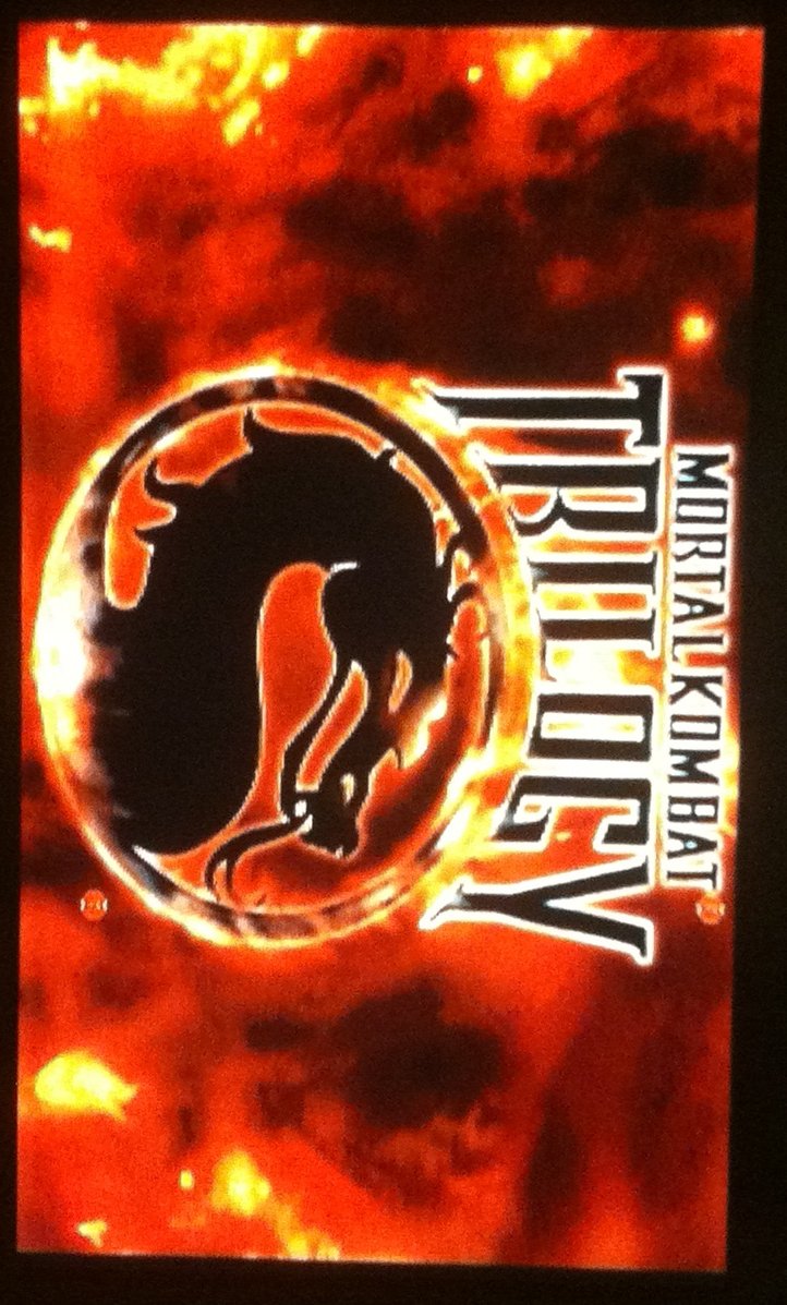

    It works like a charm (been testing it for 2 days now) Thanks Mord.Fustang for taking time to look into this. Direct boot of psx games and was able to install FreeMcBoot on the memory card using the setup CD. It's like having a MODBO chip installed with only one wire soldered inside.

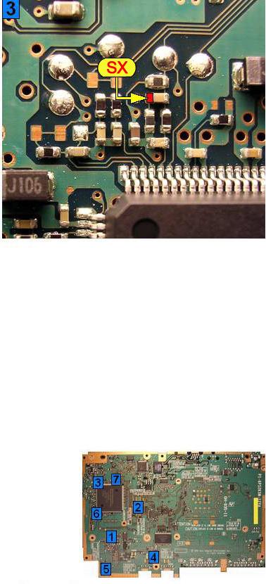

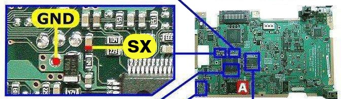

    This chip supports up to V5 (that is how old it is). I will be taking a risk and try to install it on a V8 (still has an intact warranty seal so let us pray LOL) given the fact that I'm assuming that the only thing needed to work is the proper identification of the solder point to inject "SCEA" and removal of the proper resistor on the usb end. Looking at the MODBO installation the "SX" point seems to be the one since it matches with pin #2 of the old Neo diagrams.
    Here's some Eye candy (taken with the cel phone came out sideways) the chip work was just a quick rig to see if it works and it certainly does IMG_3060.JPG IMG_3065.JPG IMG_3070.JPG :

    This is the jumper I'll be doing on the V8, if this works I'll be happy... LOL.

    V12-V16 ("SX" Point)
    truemaster1 likes this.

    Remember to remove the resistor atthe usb port (although some people say it does not need to be removed). Gonna try my V8 without removing it first. I'm kind of busy at work so it might be a couple of days before I try. I'm pretty sure it will work. But don't blame me if it breaks!!!!
