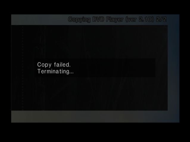

    DVD Player update discs (unaltered or cracked) will simply refuse to install files if they don't match the console MagicGate region :
