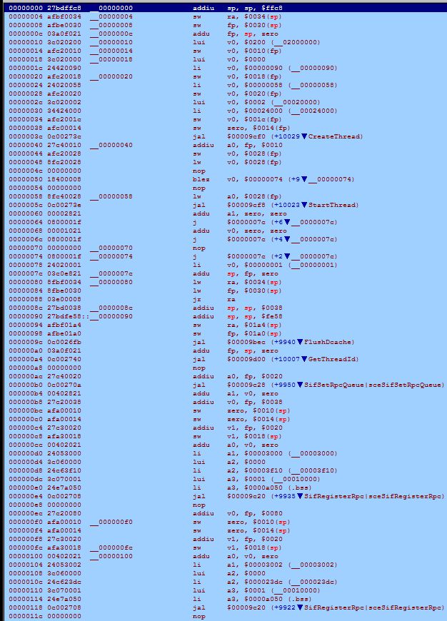

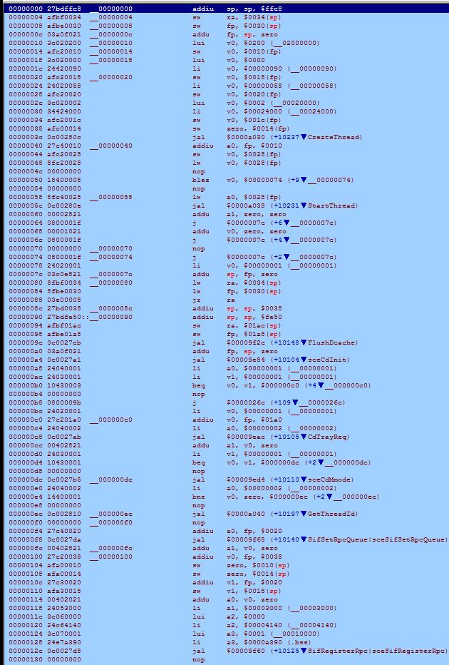

    sceCdMmode() is to ensure that the inserted disc... matches the type of disc the software was developed for (0x2 -> DVD). Obviously, a DVD Player will only play DVD discs. Who knows why they even bothered doing that... :very_drunk::topsy_turvy:
    If another sort of disc is inserted, the MECHACON will just automatically fail all requests. This has been implemented since the SCPH-10000.
    Sony: muhwahwahwahwa... now the DVD Player will play only DVD discs!
    Us: YOU DON'T SAY?
    Why does it seem like there is a pointless evaluation of the return value of sceCdMMode? Unless I'm wrong... it doesn't do anything either way? How does one get GCC to generate such code? :S
    EDIT: maybe it's because they started becoming stricter on complying with their own TRC:
