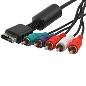

    I've once again correct "tag" (RPC-1):
    Both card shows the same thing.
    But now I've different issue.
    When I want to watch DVD-VIDEO using component cable I've no image at the output.
    Without MC, I've normal signal using component cable. o_O
    Using RGB cable everything is OK, green screen is gone and I can select progressive option.
    My console never have a modchip. She's with me from a start.

  11. Jolek
    Jolek Spirited Member
    Jan 18, 2016
    120
    165
    You know that to use component cable, settings has to be set to Y Cb/Pb Cr/Pr
    Without this option selected, normally PS2 will give you black screen.
    Here is something interesting.
    When I use RGB (scart) cable and set:
    I've a green screen. Games also have a green screen "feature".
    When I want to watch movie, colors are normal:
    Whitout MC, screen in PS2 menu\options\movies\games is green.
    If only someone else can confirm my issues with component cable.

  15. Jolek
    Jan 18, 2016
    120
    165
    @Vedita BR can you try to test the new DVD modification with composite cable:
    With componet cable I aslo don't have a picture at the output when I launch DVD-Video

    @Jolek
    Same behaviour in all the consoles I tried (with a RGB cable and the Y Cb/Pb Cr/Pr setting) :
    With the MC : Green screen in the OSD, no green screen in the DVD player
    Without MC : Green screen in the OSD, green screen in the DVD player
    That was expected. The hacked DVD player negates the temporary component video output which turns the RGB display greeny. And no, it does not rely to the OSDSYS settings unlike what I said.
    I think I found why you guys get no signal (you too @Vedita BR) thru component. That must be because your progressive option is off lol. Sorry, I really feel stupid now. All my component output tests were done in progressive output. Thanks Jolek for the reminder about the no component video output with the OSD set to RGB. Since the hacked DVD player forces RGB output with the progressive off and YPbPr output with the progressive on, it's obvious that you get no signal in i output with a component cable.
    So, it's not a matter of incompatibility with your console or faulty hack, it's the hack itself that has a stupid design. Hurr durr, musta plug a RGB cable to set an option and I cannot watch PAL movies with a component cable. Considering this, the previous mod of the dvd player is better, unless all your movies are NTSC and the progressive output stays on. I'm glad I have not updated the 3 packages with that KELF hehe.

  17. Vedita BR
    Vedita BR Rising Member
    Aug 28, 2015
    70
    I started the progressive scan version with the green RCA of the component cable plugged in to the yellow RCA input connector of the TV. I could see the Progressive Scan option, it was set as off, i couldn't change it because when i stop the DVD playback the TV Shows no signal.
    krHACKen likes this.
  18. Vedita BR
    Aug 28, 2015
    70
    Update: As jolek suggested, i started the DVD with composite cables and then i could turn on progressive scan setting..
  19. krHACKen
    krHACKen Enthusiastic Member
    Oct 24, 2012
    571
    376
    Nice.
    And now the progressive scan setting is on and saved to your mechacon nvram, you can run the hacked DVD player with a component cable, is that correct ?
    To summarize :
    With the progressive scan on = component cable only
    With the progressive scan off = RGB/composite/S-video only
    To turn the progressive scan on, you need a RGB/composite/S-video cable.
    To watch movies in progressive, you need a component cable.
