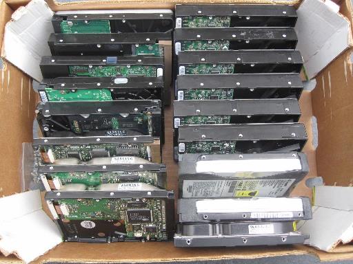

  19. blueheaven
    blueheaven Spirited Member
    Aug 9, 2012
    108
    Offtopic:
    OK the drives have arrived :)
    Now to find some time for installing these...
    And start playing with POPS :wink-new:
  20. krHACKen
    krHACKen Enthusiastic Member
    Oct 24, 2012
    571
    376
    Nice !!!
    Oh, Fujitsu and Seagate drives:love_heart:. The Wertern Digital CAVIAR on top-left will not fit the Network Adaptor.
    If you install the Rev.10 KELF, I recommend you to do BOOT2 = pfs:/EXECUTE.KELF installations rather than PATINFO installations, as POPStarter will be kicked to Rev.11 within a few days; and updating one hundred PATINFOs in a HDD would be sort of pain in the butt:congratulatory:.
