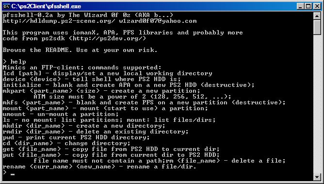

    pfsshell-0.2a for the win. Get you a IDE to USB adapter and hook your HDD to your PC.
    The stuff I'm using :
    That's a broken external HDD enclosure + an ATX PSU:biggrin-new:.
    Transfer speed is about 25 MB/s, takes no more than 2 minutes to copy a 700 MB disc image.

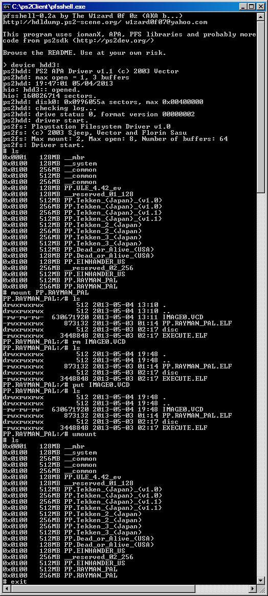

    That's right. But I personally prefer the USB connection, as I don't want to shut the system down before I plug/unplug the HDD.
    Yep, command line.
    The command "help" prints this :
    Some basic operations here :
