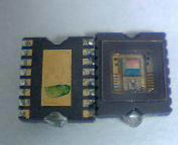

  9. H360
    H360 Familiar Face
    Mar 5, 2011
    1,474
    Yes. Thank you Bad.
    I did mean something like this...
    NOT this...
