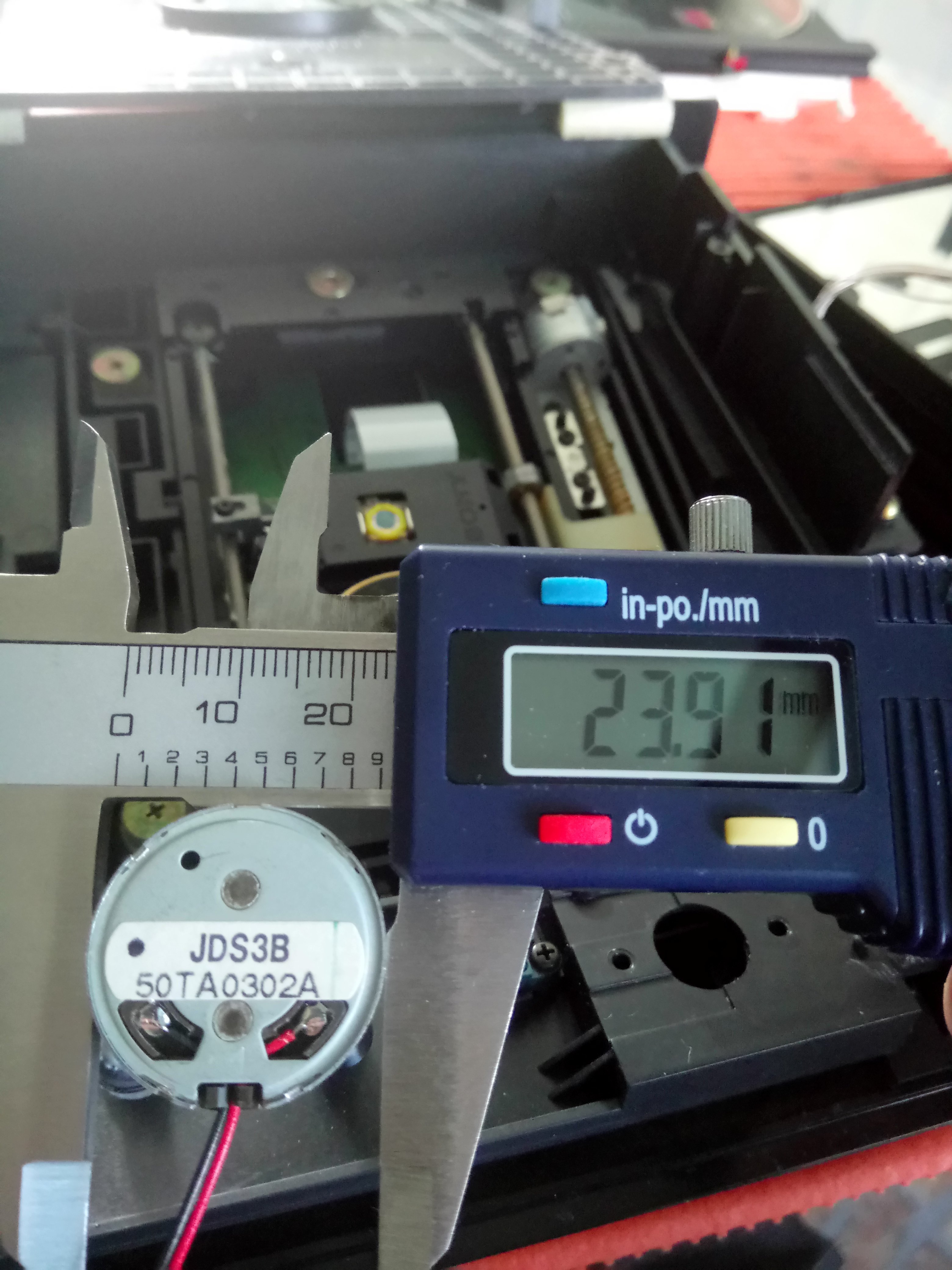

    Anyone know of a proper sized replacement for this motor (JDS3B 50TA0308A motor) ? I booted up My 10000 model to rip some music cd's to my BB unit's HDD but it wouldn't eject.
    I took it apart and the motor barely moves without a belt on it, its toast.
    Is there a way i can restore it perhaps?

    I can assure you that it is the motor. As i stated, the motor will completely stop if you barely touch your finger nail on the motors brass pulley as it spins (while the motor is removed and has no belt on it at all).
    Initially i cleaned the belt then replaced it, which is why i removed the screws and pulled the motor out and kept hitting eject while lightly touching it as it spun. The motor has no strength left at all.

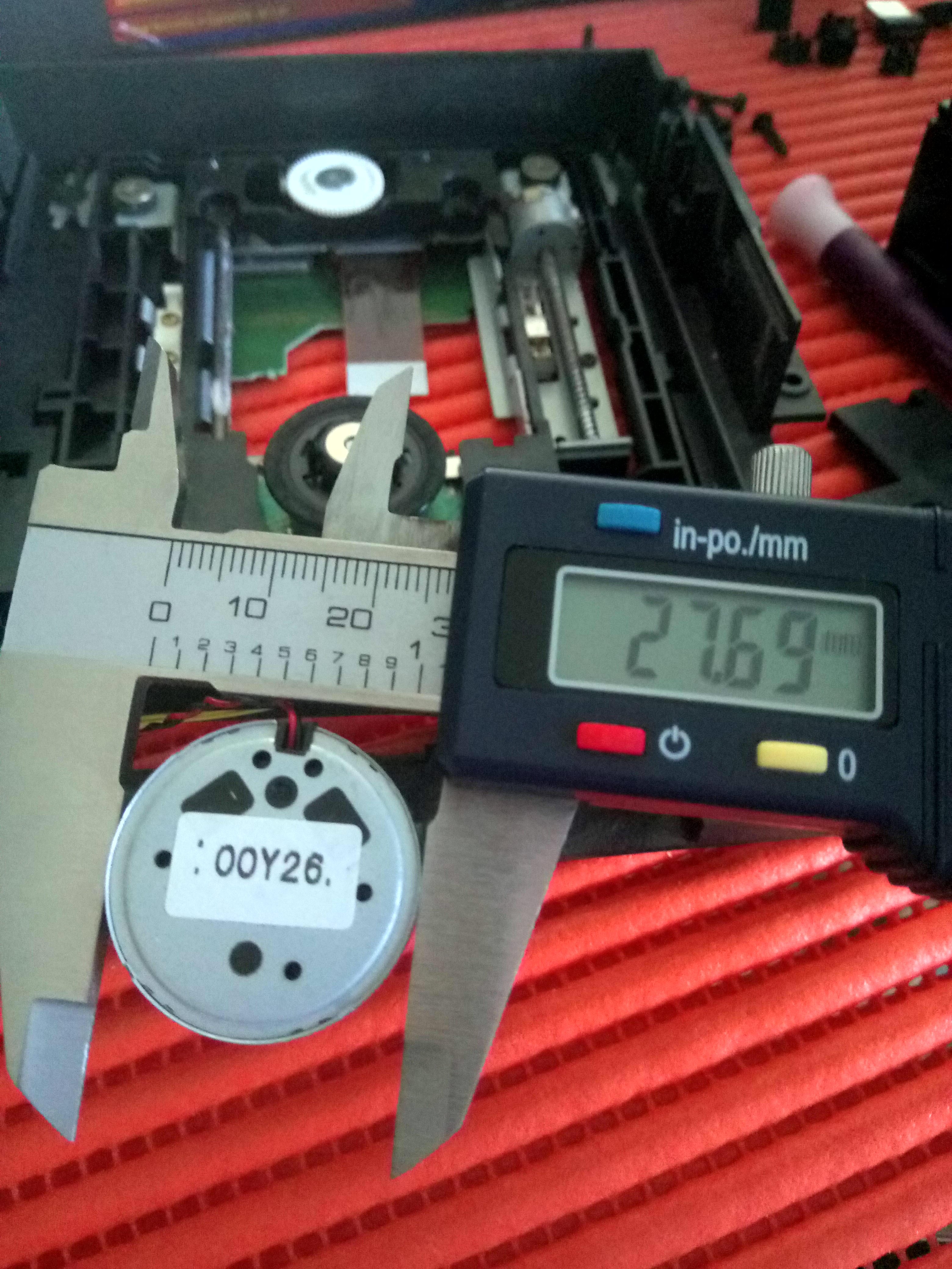

    I also desoldered the motor and soldered in one from a fully functional ps2 disc drive. The motor spun with loads of strength. I cant use it unfortunately because its almost twice as thick and 50% larger diameter. The early Japanese models used such a small motor, its probably why its almost dead, just too small for the application its used for.

    @OP: Well, one thing I can tell you. You can salvage that motor from any 10-screw unit, fortunately. The early USA ones will come with a motor which may match the required cable length and will also have the proper plug already fitted. The first 8 screws model will have the same motor but the motor wiring will be a tad shorter.

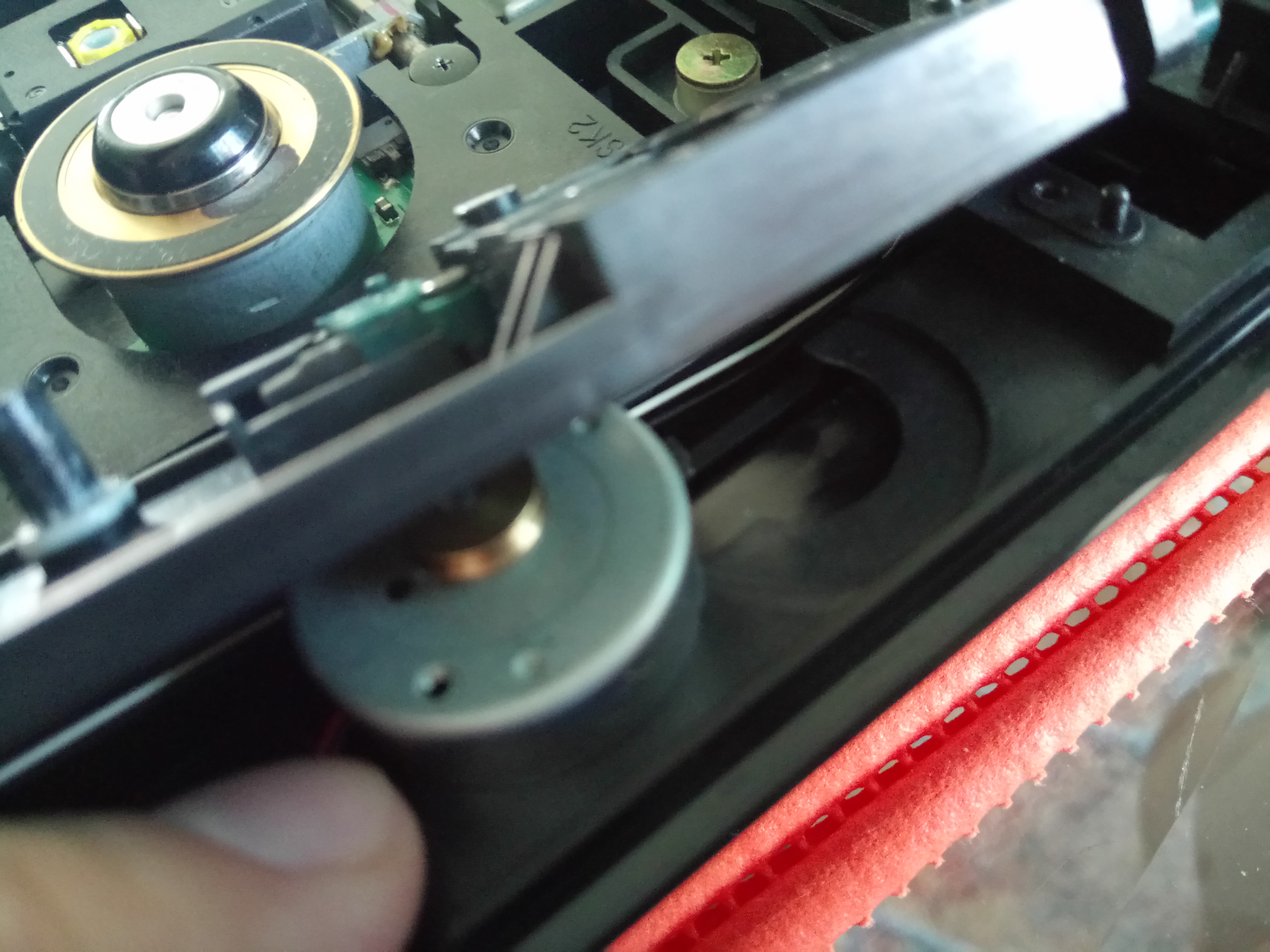

    The wires are never an issue, i can solder in the motor. The problem is, the motors are different diameters and the Japanese console is molded to fit that exact size motor. The north American motors are almost 4mm larger diameter and simply will not seat down in the hole in the lower half of the shell. DSC_0205.JPG DSC_0202.JPG DSC_0203.JPG
