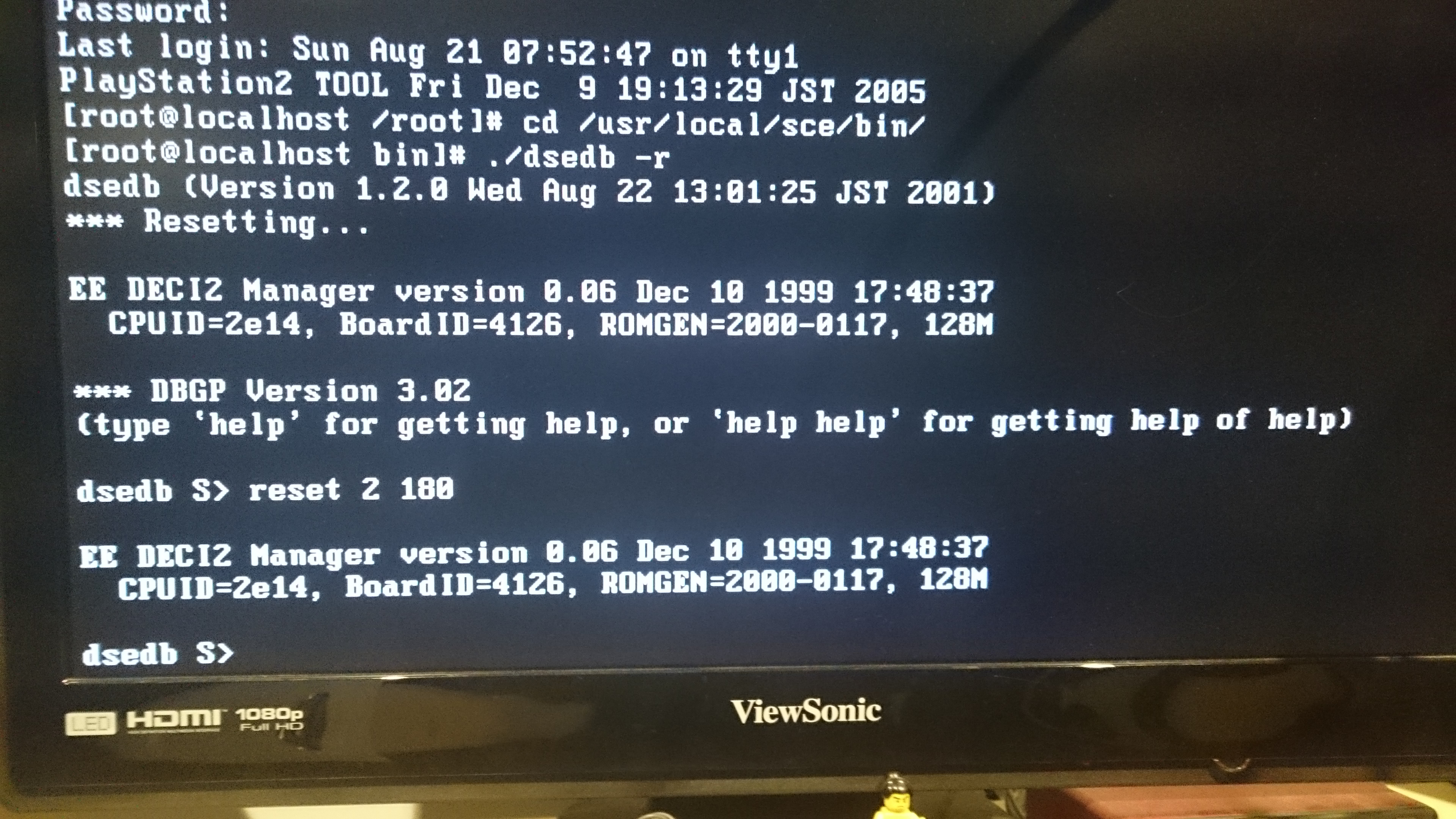

    I'm not sure why I can't run dsedb remotely, or am I just doing it wrong? After trying to fix that for a while and failing I just logged into the tool directly to try running a retail game, but after running reset 2 100 (or 180) it just stays on a black screen no matter how long I wait. Nothing interesting on the PC side either:

    Update your flashrom to the latest you can find. Latest I could find is t10000-rel300.bin. Should solve your issues booting retail games whilst logged in to the TOOL unless it's a drive/laser issue. Documentation required to flash is in the SDK documents (setup3.0.pdf or something on mine) which i'm assuming you already have. Or flash using ProDG Target manager. Hope this helps.
    Also, the documentation explains this but make sure you update in TOOL mode and not WS mode unless you want to overwrite your backup flash bank. Just read the docs and it's really easy to figure out!

    Your dsedb build date looks very old. You should probably try a newer version.
    Mine were dated 2003.
    That ROM version is suspiciously old. Did you set the mode switch to TOOL mode?
    If it is set to WS mode, you should probably not flash it because WS mode is not used for development and was left as a brick-recovery mode.
    FlamingSpaz likes this.

    Thanks for the tips, will try them out. The switches are in CD/DVD Drive and TOOL mode.
    I also burnt a master patched copy of MGS3 which works in a debug ps2 but not the tool. I hope that's not a sign of a bad drive/laser :(

    It doesn't work because the version of the flash ROM that you are currently running, does not have it implemented.
    Initially, the developers booted software on Master Discs with a custom program (that they have to write on their own), which uses LoadExecPS2.
    You need to get the ROM sorted out. I don't know if any TOOL ever had that early version of a ROM for its TOOL mode, but it sounds suspicious...

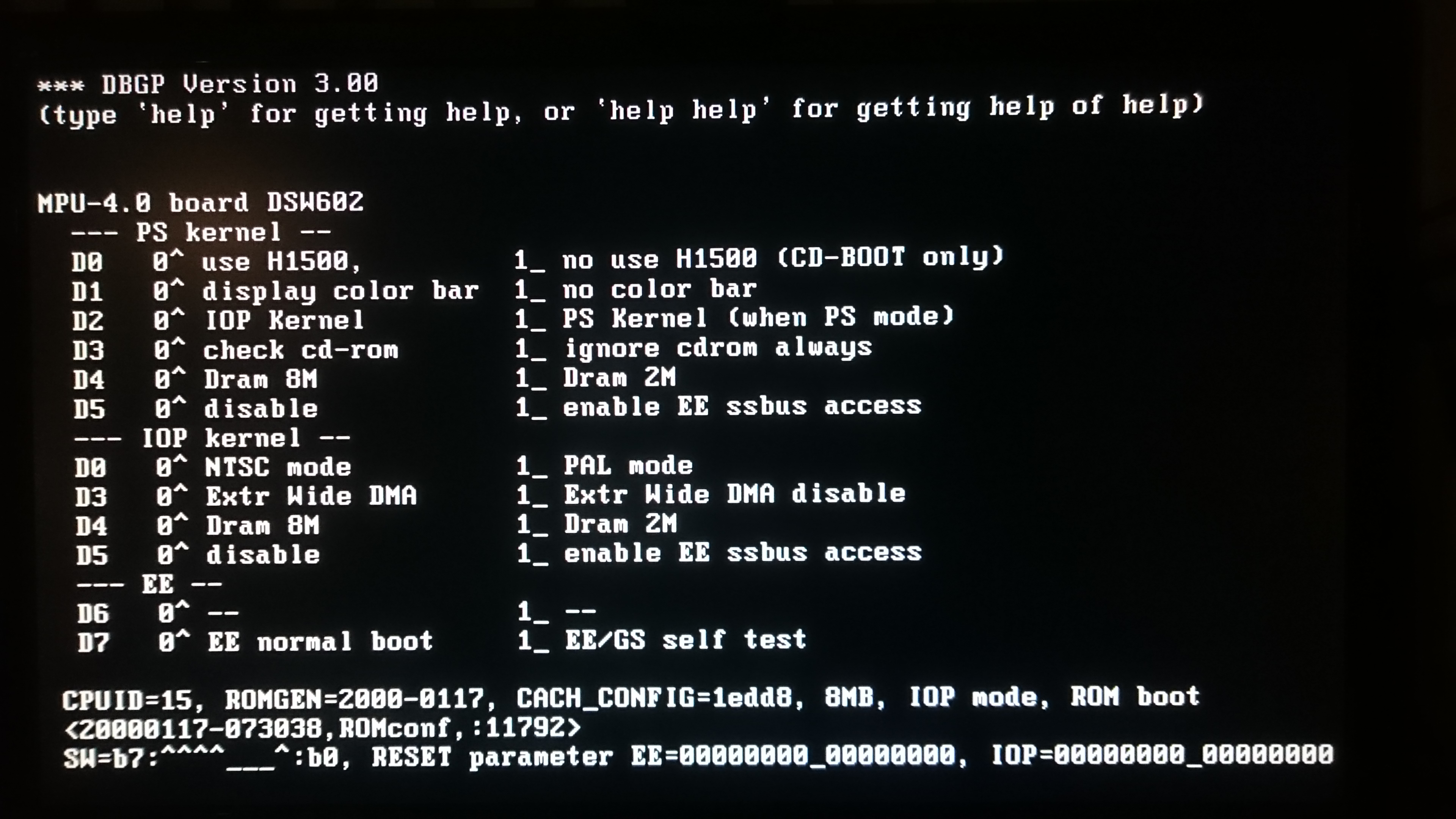

    The switch at the front is definitely in TOOL mode, here's the output of dsidb which shows the configuration of the DIP switches at the back
    Anyone got any ideas? The only other thing I can think of is that the tool shows the hostname as "localhost.localdomain" but dsnetm should still be listening on the LAN IP address right?
    Edit: I don't think that does show the switches on the back. The back switches are _^__^_^^

    Are you sure that you entered the IP address of the TOOL correctly (dsedb -d <TOOL IP address>)? The IP address that the TOOL got is displayed when it has finished booting up.
    The DSW602 board's DIP switch is inside the TOOL, which is not the WS/TOOL switch and is not the rear DIP switch either.
    dsnetm on the TOOL will be connected to /dev/mrp0 (the default), not the network.
    If you want, you could check whether the TOOL/WS mode switch s connected properly to the TOOL or not.

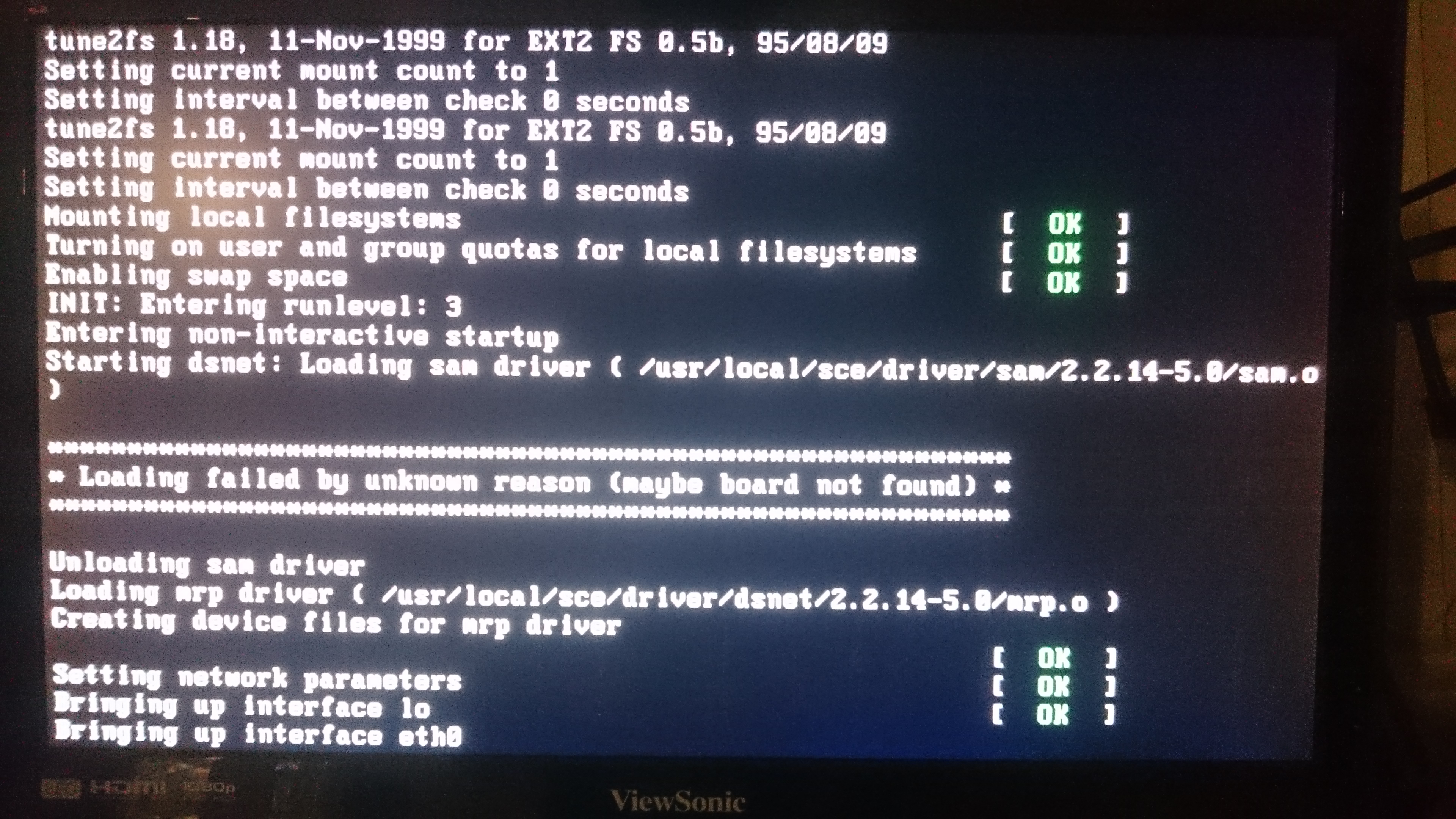

    Ok, after some fiddling I updated the dsnet package and flashed the newest firmware from the tool itself. It can now boot games!
    dsnetm still isn't working, but at least there's an error message now:
    Yup, same as the one shown on the TOOL side.

    It is working, otherwise you would not have been able to connect.
    The SAM driver doesn't work on any TOOL.
    Now that you have the ROM flashed to a newer version, you could simply flip the switch and press the RESET button. If the ROM version does change, then it is working fine.
