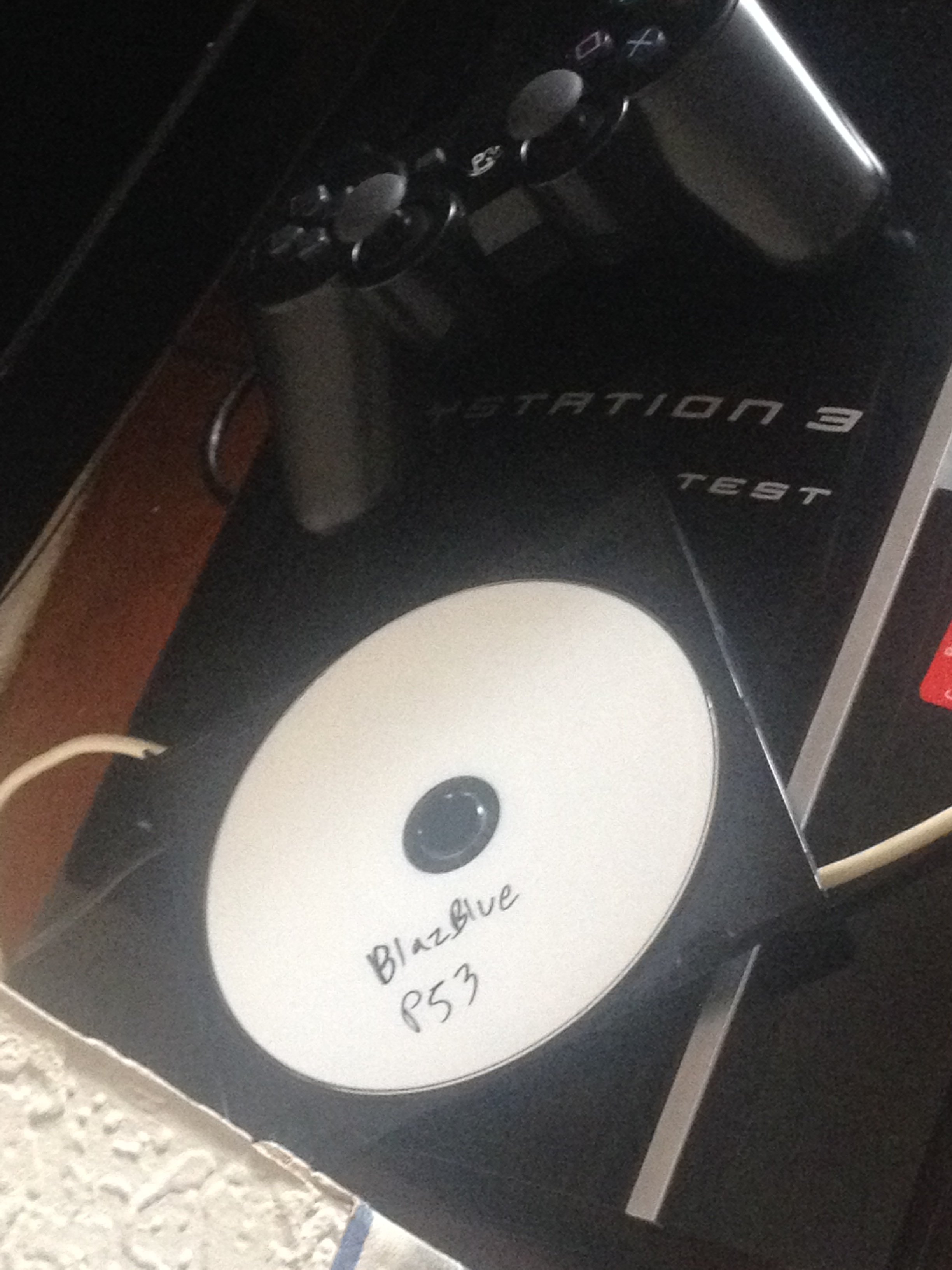

    I recently purchased this blazblue calamity trigger prototype of someone on eBay,
    but it isnt loading in my test Ps3
    original pic of disc
    [​IMG] unlike when i put in in a blue ray movie it just doesn't work put in a ps2 game shows its not supported but this just keeps loading

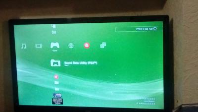

  13. deveb
    deveb Active Member
    Oct 16, 2017
    38
    i have it on the system now the game is loading [​IMG]

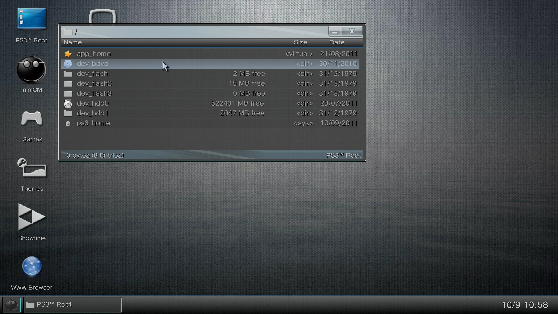

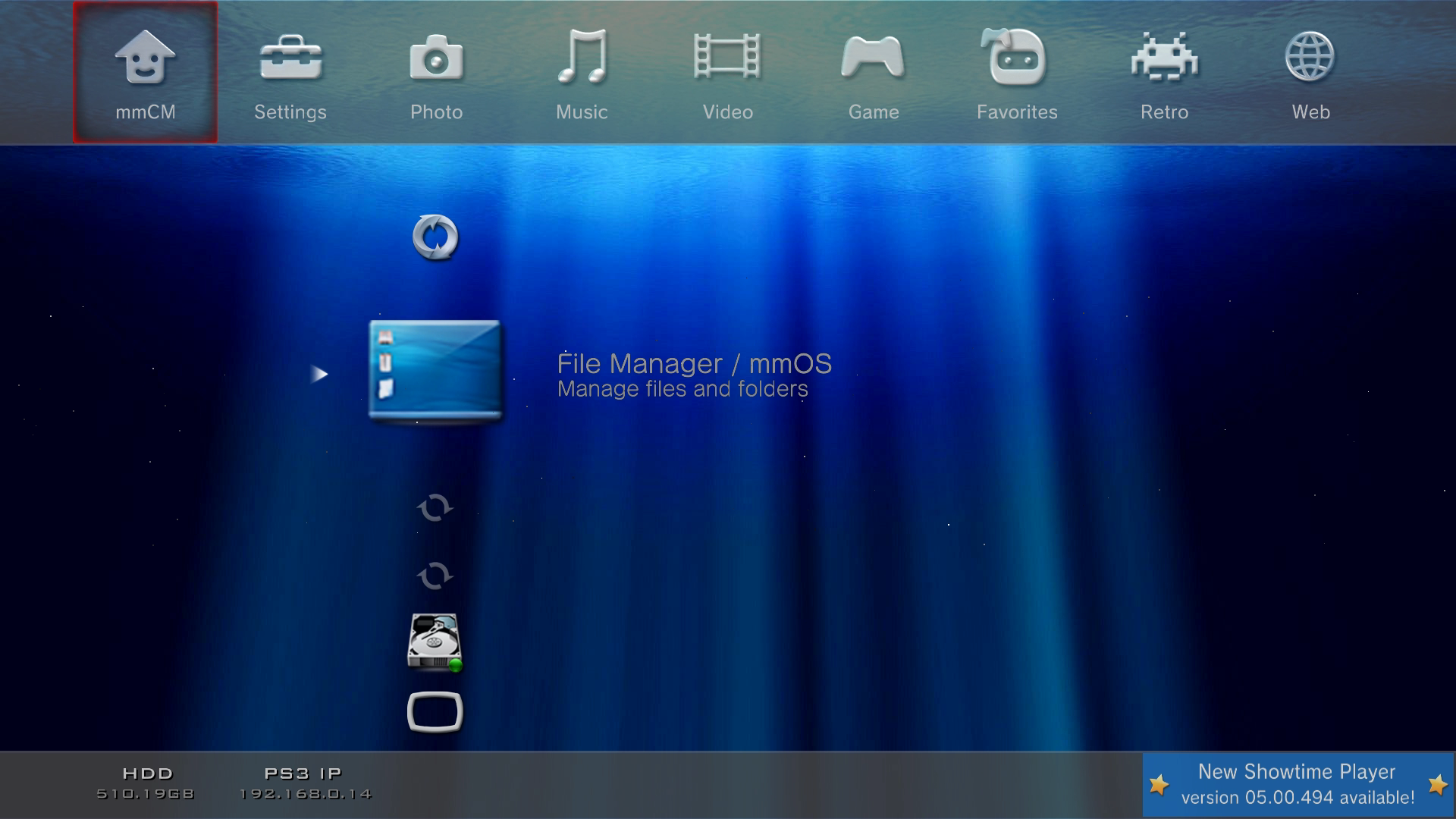

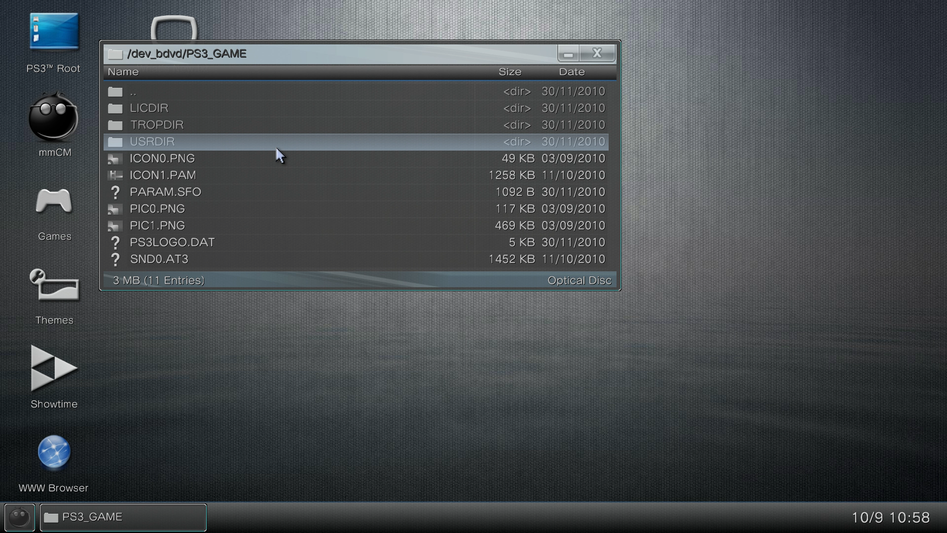

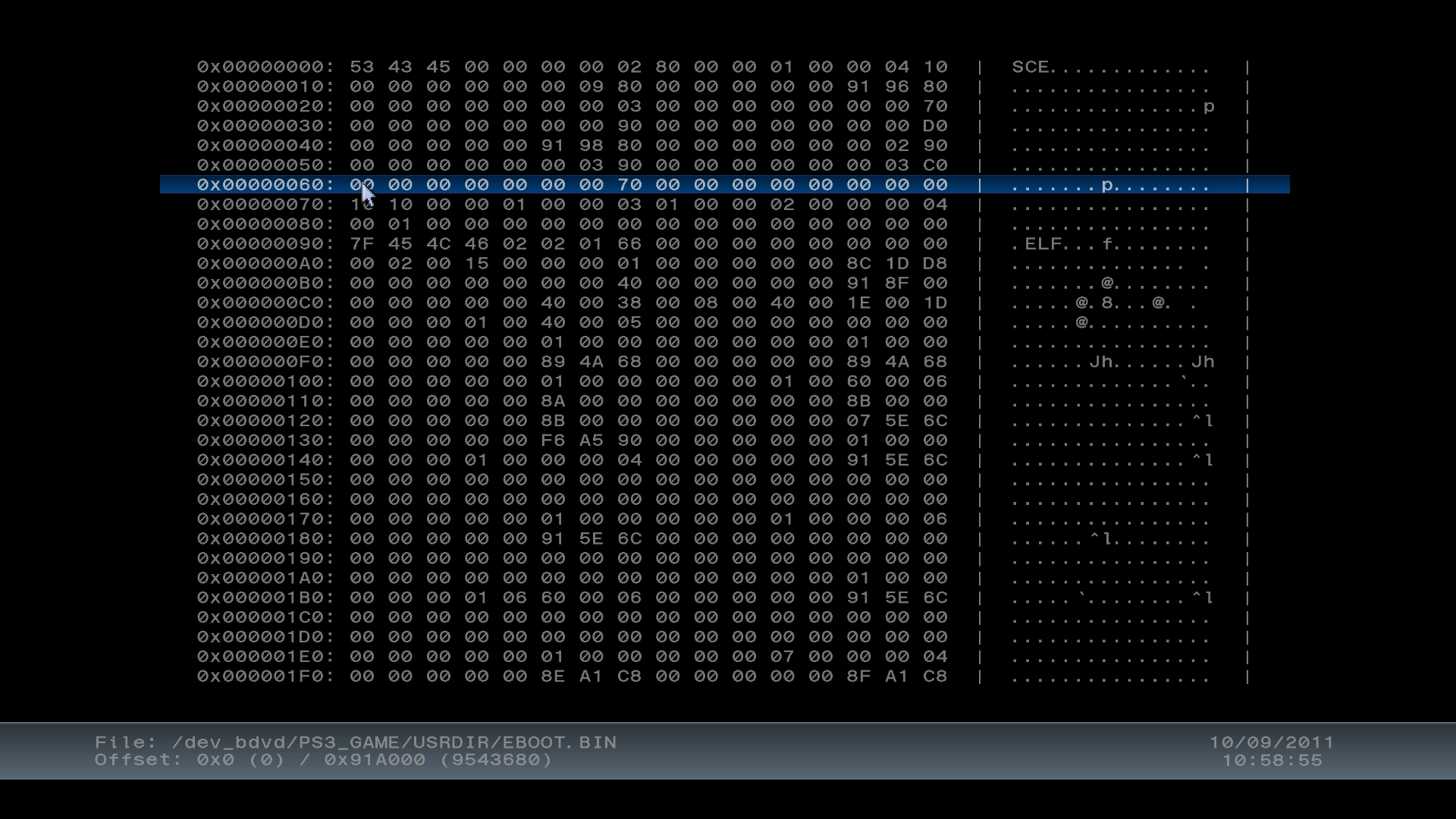

    If it doesnt show on the XMB does Multiman detect it? Start Multiman first, THEN put the disc in and see if results change.
    There's an option to explore the contents of stuff on the system in multiman (furthest to the left, should be called File Manager / mmCM). Open it and you'll get a desktop looking setup.
    Open "PS3 ROOT", open "dev_bdvd", and navigate to the eboot.bin. Press X on it then circle and open in hex viewer and show me what comes up. A photo of the screen is fine as long as I can see the first files.
