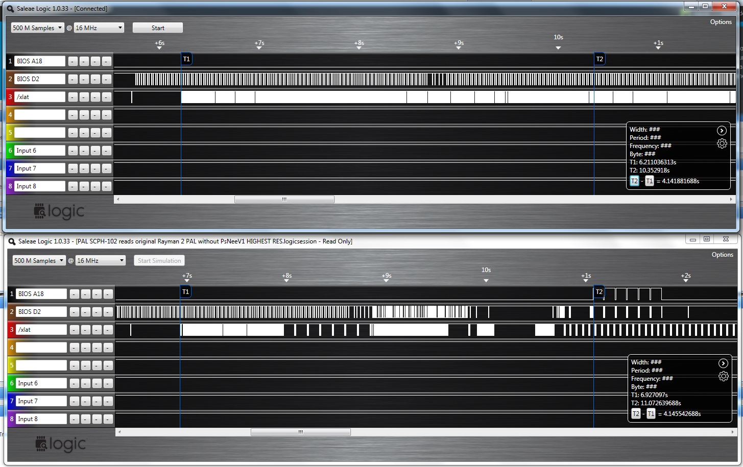

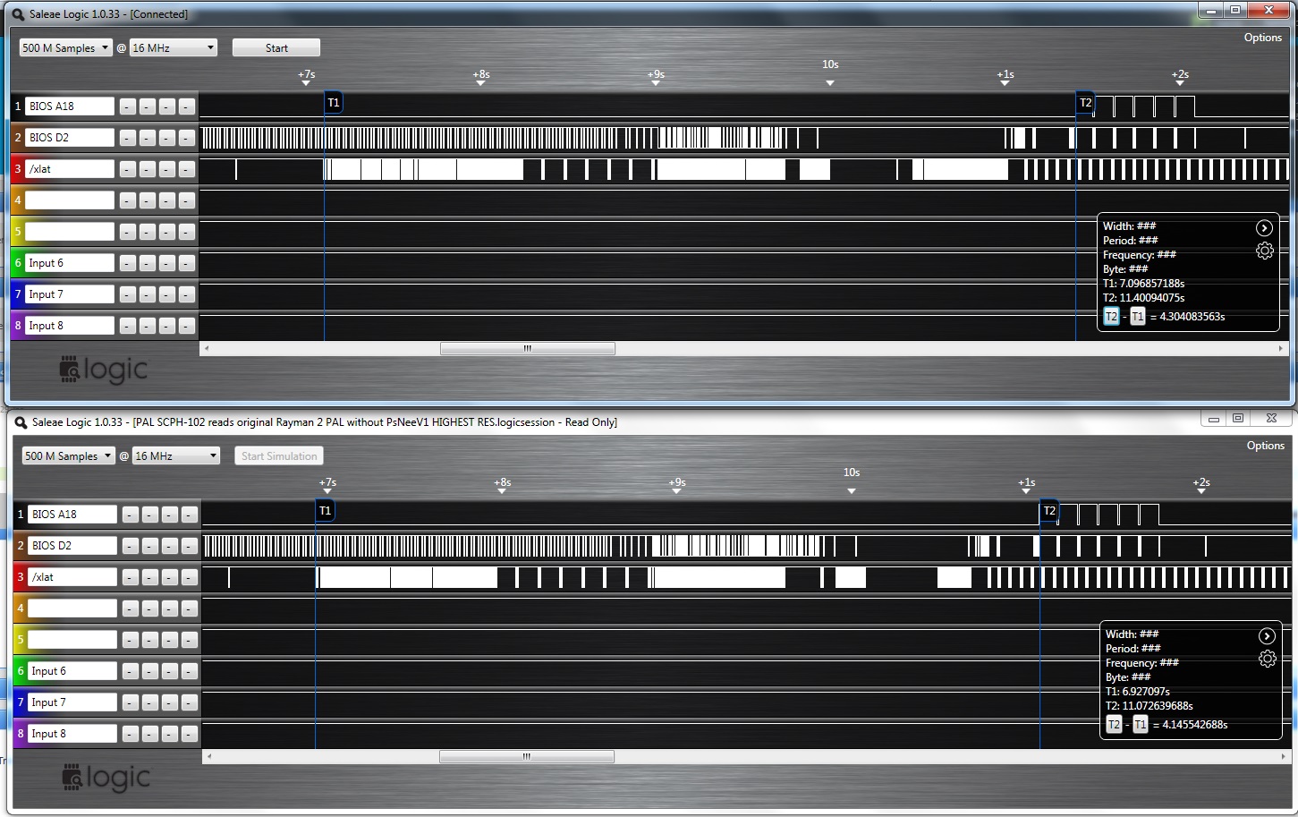

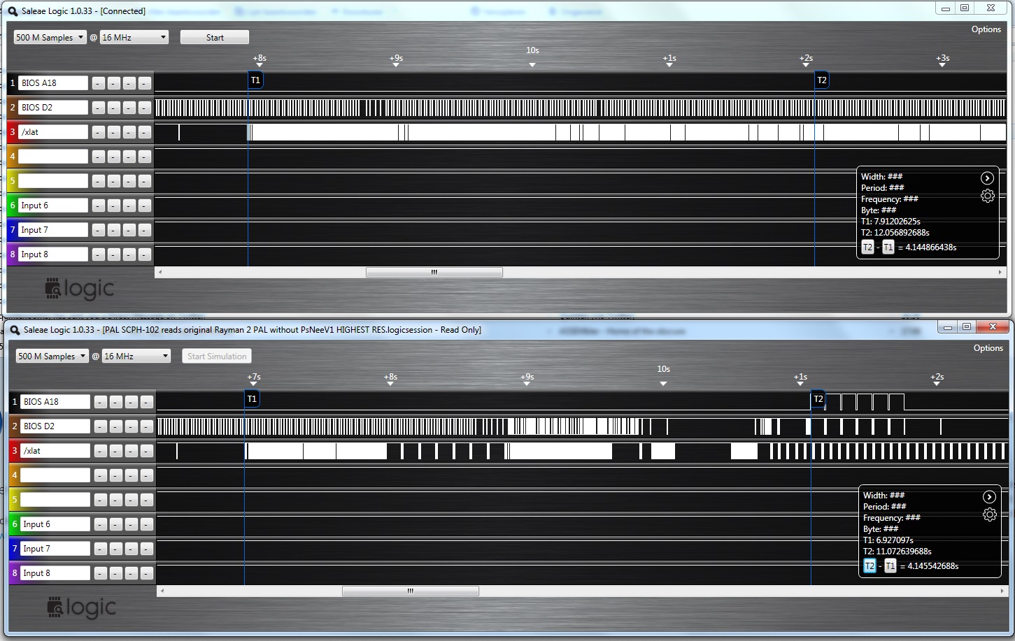

    Well, it all seemed a bit too good to be true :-/
    The A18 signal at about 11 seconds is only generated with original discs, not with backups, neiter of PAL nor NTSC region. I've included screenshots comparing the logic captures from various discs. I don't really know how to proceed from here, anybody's got any ideas? TriMesh?

    OK, does the PAL backup actually boot? That looks like it's failing the validation early on and isn't even getting as far as the license check.

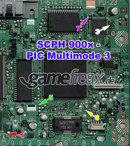

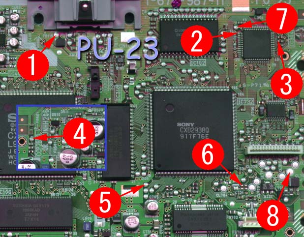

    Board: PU-23
    But it does not work :(
    Is it right that only 5 wires are soldered? Pin 3,4,5,6,8 Right?
    On the pictures for wiring the v2 only these numbers are used, all other points have no numbers.
    Seems that V2 changed from pin 7 to 3 as at the beginning frietman wrote pin 3 not Connected, but on the pictures for v2 it is used. 1,2,7 are not connected regarding the pics.
    Iam a bist confused now, and dont know why it does not work... Any idea?

    There are some issues with PsNeeV2, I won't recommend installing it in your Playstation, I only posted it to show some progress, it was not tested on actual hardware.
    @TriMesh: I've tried spamming the SCPH-102 withe SCEx-codes, but it won't ever authenticate a NTSC disc, it never gives off the A18 pulse at about 11 secs like original and PAL backups do. Is there something else I need to watch for?

    15
    Then dig up a wiring diagram for a normal modchip like MM3 and use that wiring diagram with the pin conversion table I posted :)
    I've included one I had locally for convenience.

    Oct 8, 2015
    Okay, the one i found looks different... Now iam not sure which one of them is fitting psnee :D

    15
    I can't see your image, but pin 1 indeed is Vcc, that can be tapped off various points on the PCB.

    Not that I can remember - I just had a look, and I don't have any SCPH-102s here to run tests on. I will try to get one and see what results I get.
