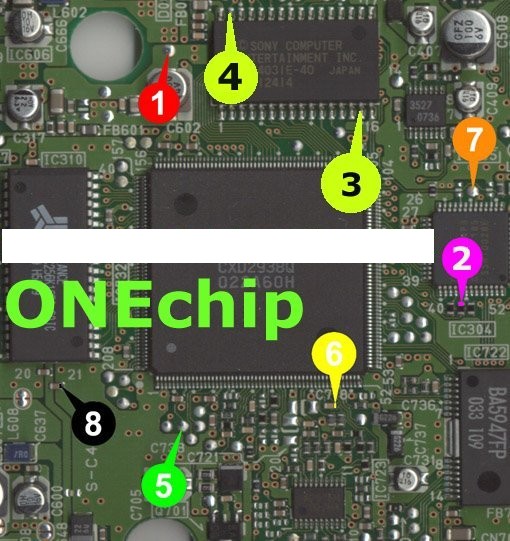

    i have a schp-102. it doesn't read original discs, but backup discs are working, so it's not a laser problem. i don't know what type of modechip is, but i think it's a onechip because is connected like the one in the photo. the modchip is placed on the chip where the 2 and 7 point are. could that be a problem? when i remove the modchip, the original discs are working.

    That diagram looks like the scph-101 board, not tthe 102.. correct me if I'm wrong. I have to go home and look at my PS1 mod archives

    i think 101 is ntsc and 102 pal. but i know for sure that there are 2 versions of psone boards: pm41 and pm41(2)

    Mine loads both just fine, no idea what the chip is programmed with though.
    I took the chip out of my SCPH-101 and popped it into my SCPH-1001 and it took the changing of a few wires on the chip as well as a few different diagrams before I found the right combo to get it to boot everything properly.

    Easy fix.
    The GREEN wire must be wired to the board.
    Without the green wire soldered, you can not play originals.
    I had the same issue as I forgot to solder it on...
    (If it is soldered on, then it may not be soldered on the correct pin or link on the PSone mainboard)
  20. bacteria
    bacteria I am the Bacman
    Apr 8, 2008
    978
    The PSone had a few revisions, which is annoying, and each revision needs to be wired differently with a modchip. Other consoles don't seem to have revisions much; however even the official Playstation controllers can look different inside and wire differently inside. Annoying!
