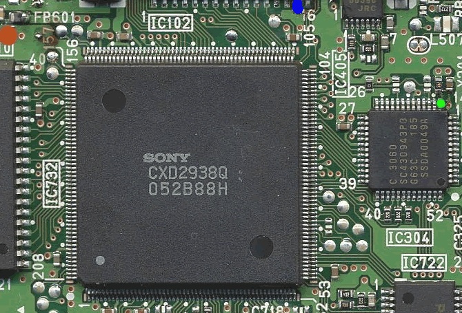

    Hello,
    Could anyone please tell me what the three components are underneath IC304? They have "220" written on them. I think they could be fuses but I am not sure.
    Background info:
    I decided to mod this PSOne years ago and unfortunately I wasn't very good at soldering and as a result managed to lose all three of these components. I returned to this console recently and managed to replace them thanks to a scrap SCPH-9002 board. The one on the left had it's bottom solder pad ripped off but luckily I scraped of the top layer of PCB to reveal the trace and bridge with solder.
    Anyway the PSOne all seems to work brilliantly :D But I was still curious to see what these components are...
    Thank you for any information :)
  2. Bad_Ad84
    1,309
    22ohm resistor.
    Don't know package from memory though
  3. martin_crickett
    martin_crickett Rising Member
    Jul 20, 2012
    50
    Ah! Thank you very much for the info :)

  5. martin_crickett
    Jul 20, 2012
    50
    Thanks guys :) the resistor on the left of the image has been removed and instead a piece of wire is bridging the top solder pad to the trace. What negative effects could there potentially be? Ie could the laser mechanism die quicker than usual?
    It's not a problem because this particular console will never be used, it was nice to just simply get it working again.
  6. Bad_Ad84
    1,309
    Resistors are there for a reason. A piece of wire isn't a resistor. Why do people think you can just ignore components? Would you do that in a car?

  8. Bad_Ad84
    1,309
    Damage the console, functions not work correctly, chips frying. The usual
  9. master991
    master991 Enthusiastic Member
    Jun 4, 2012
    597
    You can also use a standard 1\4W resistor, the important thing is that you bridge nothing...
    Bridge must stay only on rives :p

  11. martin_crickett
    Jul 20, 2012
    50
    Solder bridge removed, reworked including resistor.
    All is well :)
