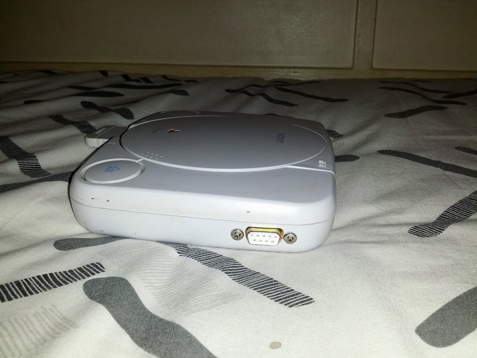

    Hey guys, I need some help with the patched net yaroze boot cd and serial loaders.

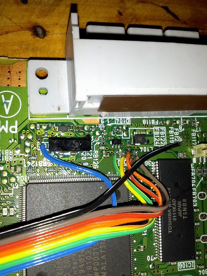

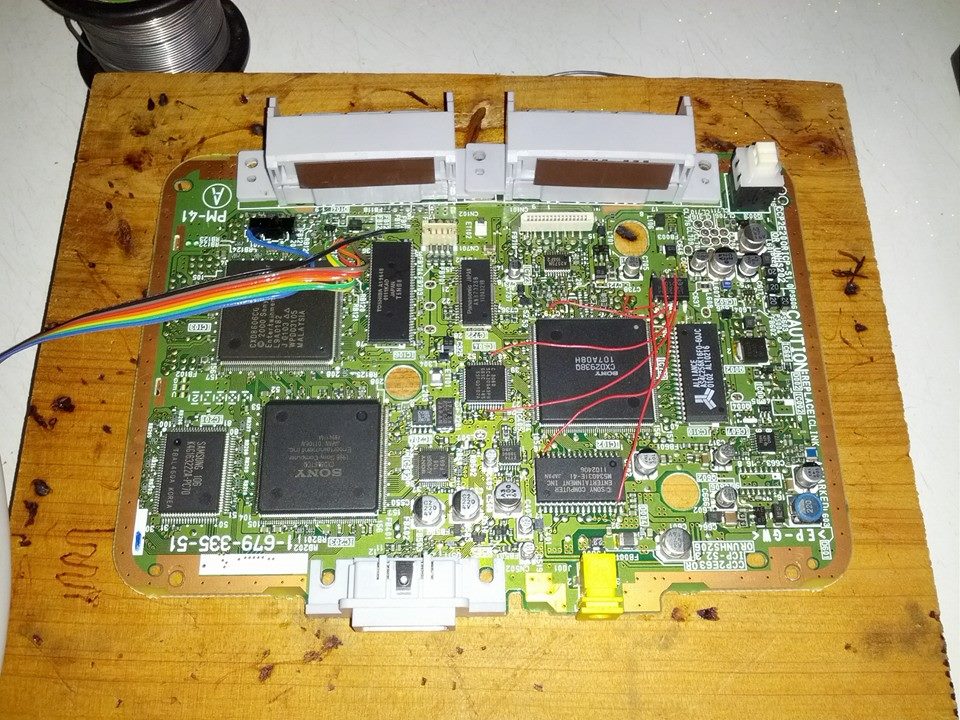

    Just did the serial port mod on my modchipped SCPH-102 and it turned out very tidy. I am using a PL-2303 serial converter to do the work to connect it from the DB-9 in the ps1 to my pc's usb port.
    Then I burned a cracked net yaroze boot cd, hitman serial loader and also the psxserial loader on to 3 different cds using cdburnerxp. Hitman loader suggested to use CDRWIN so I used it for that.
    However none of my disks boot on my PS1. Images worked OK in the emulator but my disks also don't work in the emulator (they say IOcontrol: raw read error, the parameter is incorrect.)
    So basically I burned 3 lemon/coaster CD-Rs.
    Any idea why this is happening? I saw everyone else has success. Let me know if you can help! Maybe I'm burning it wrong....
