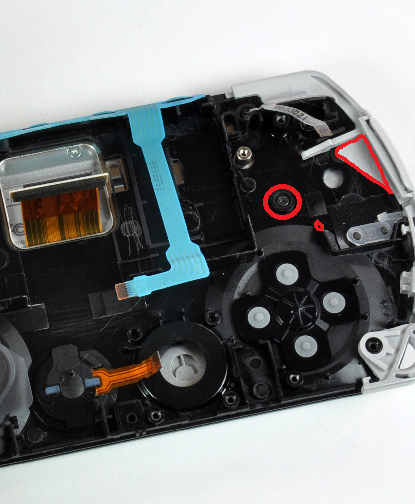

    For the card to fit in the case some plastic had to be removed. The shroud from around a screw, a small piece of upright and the white piece behind the card slot.
    I put it all together and was going to see how it lined up before applying some glue, but found that it sits and functions perfectly, so I kept it as is without glue. It is just floating there but there is not a lot of movement as the short length of the ribbon cable stops it from pushing inwards. Card is easily ejected and inserted.
