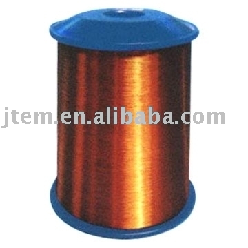

    PS2 (two) have small soldering points.. but also for the future a soldering needle or even an amateur soldering station is a good investition.
    Training on an old electronic device .. maybe an old motherboard, PCI card etc.. might help?!
    Hm, using thinnest solder and thin and coated (often transparent) copperwire with no plastic-shielding makes it easier. you only need half a second for a good connection. + the coating melts away and you dont have to cut off shielding from cables etc.
    I found those single wires easier to tame and glue/fix to the board for a nice layout. You can bend the Wires in 90° angles and they stay put, thanks to the missing plastic-shielding.
    Contra: all wires will have the same color ;)

    Well I have one pretty fine tip for my iron, cerainly less than 1mm at the point. I think that would do the job. Might get some of that copperwire, looks ideal for this kind of thing - I'll just put tags on to remind me which wire is which.
