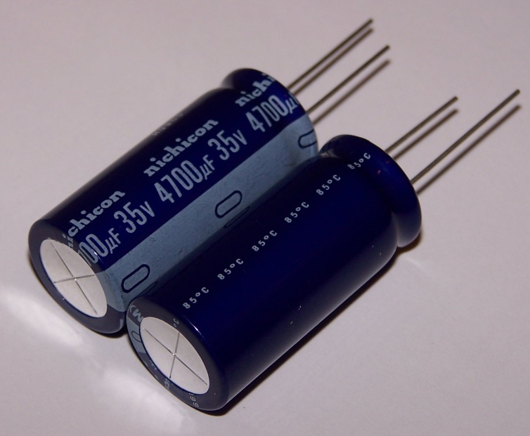

    I got the capacitors ordered.
    Should be here in less than 8 weeks -_-
    Will update then...
    Oh, I got the same brand, top quality Japanese capacitors. In particular, the Sony DTL's use the Nichicon brand.
    I went with electrolytic. I could have used the solid ones (forgot the name) but it doesn't matter...
    Sony DTL-H2000 CPU-board:
    47uf at 16v,
    10uf at 16v,
    100uf at 16v and
    220uf at 10v.

    Okay. Update time.
    Bad news: My soldering iron broke again (ceramic element is bad).
    Good news: I received all the capacitors AND ordered a new Hakko FX-888 soldering iron yesterday.
  10. H360
    H360 Familiar Face
    Mar 5, 2011
    1,474
    Received the soldering iron today. It is the best soldering iron I have ever worked with.
    70% of the capacitors have been replaced... I will update again when I actually plug it in, and let you guys know what happens.
