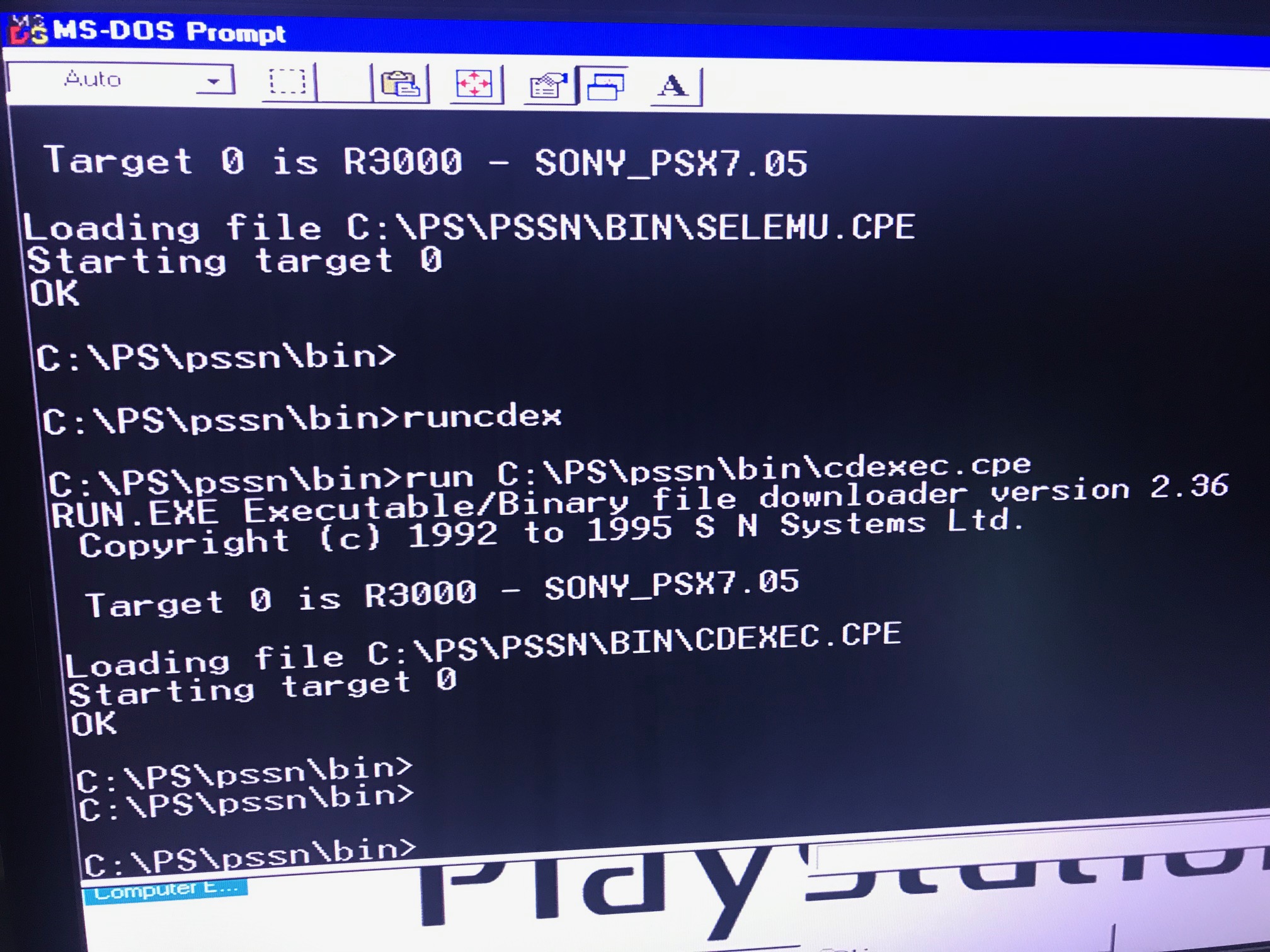

    On windows i start first init the hardware:
    H25bios = OK
    CDBIOS = OK
    Than i switch the H2500 from cd to Emu with " runselem " = OK
    After that what i know i need to start the image with "CDEXEC" = OK
    But the HDD is not start doing anything. Playstation AV Output is also still on standby.

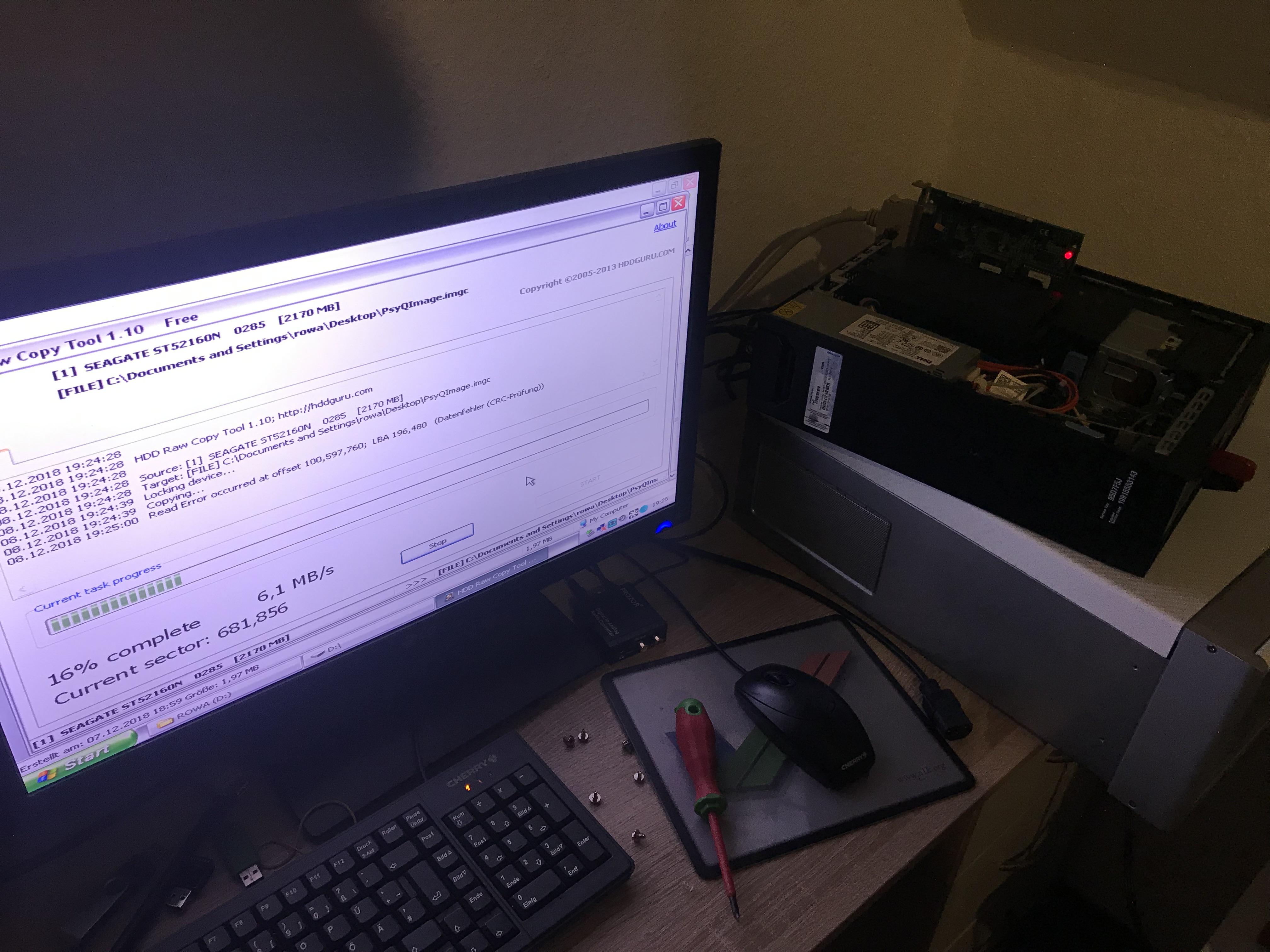

    Oh no not this tool again :) Ok i build my scsi card in old pc from work with xp and the image is running now!! 2GB are the size of the HDD. How to open the image after that progress?
    edit: There Data on the disk 989MB thats what HDD Raw tool writes into the image.

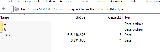

    There are 2 read errors when i create the image. I tryed it three times.
    So now i have the image but i cant extract it. I tryed IsoBuster and Winrar.
    Winrar shows me the Files in the image but cant extract it. It looks like there is still a game on the disk!!!

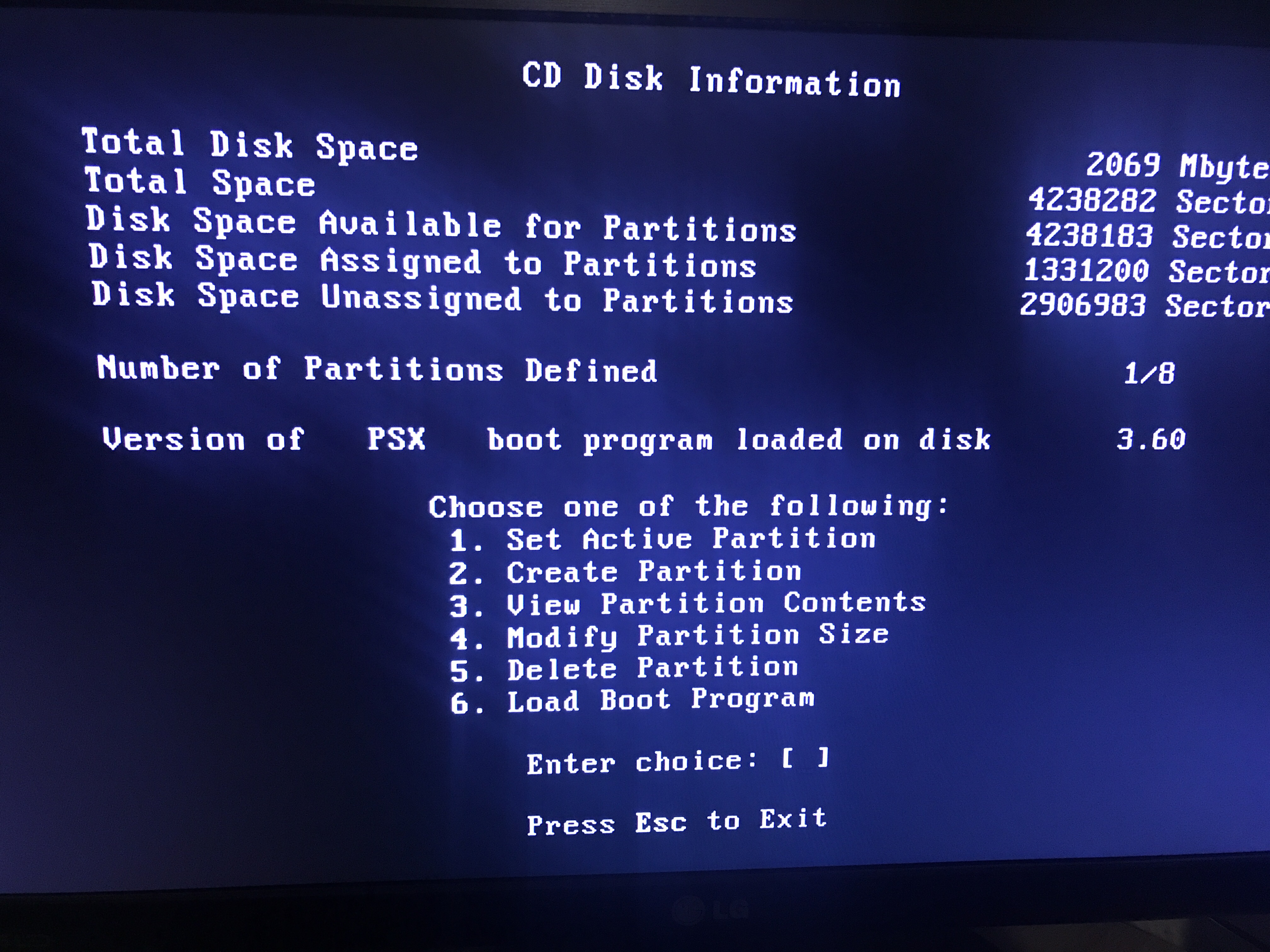

    You're using the CD emu tools for DOS, not the ones for Win9x, right?
    Otherwise you'll need to run CDDISK with only the SCSI ID of the hdd as argument, no other option, and definitely not -n as it initializes a new disk.
    And take pictures of what CDDISK output looks like while you do it.

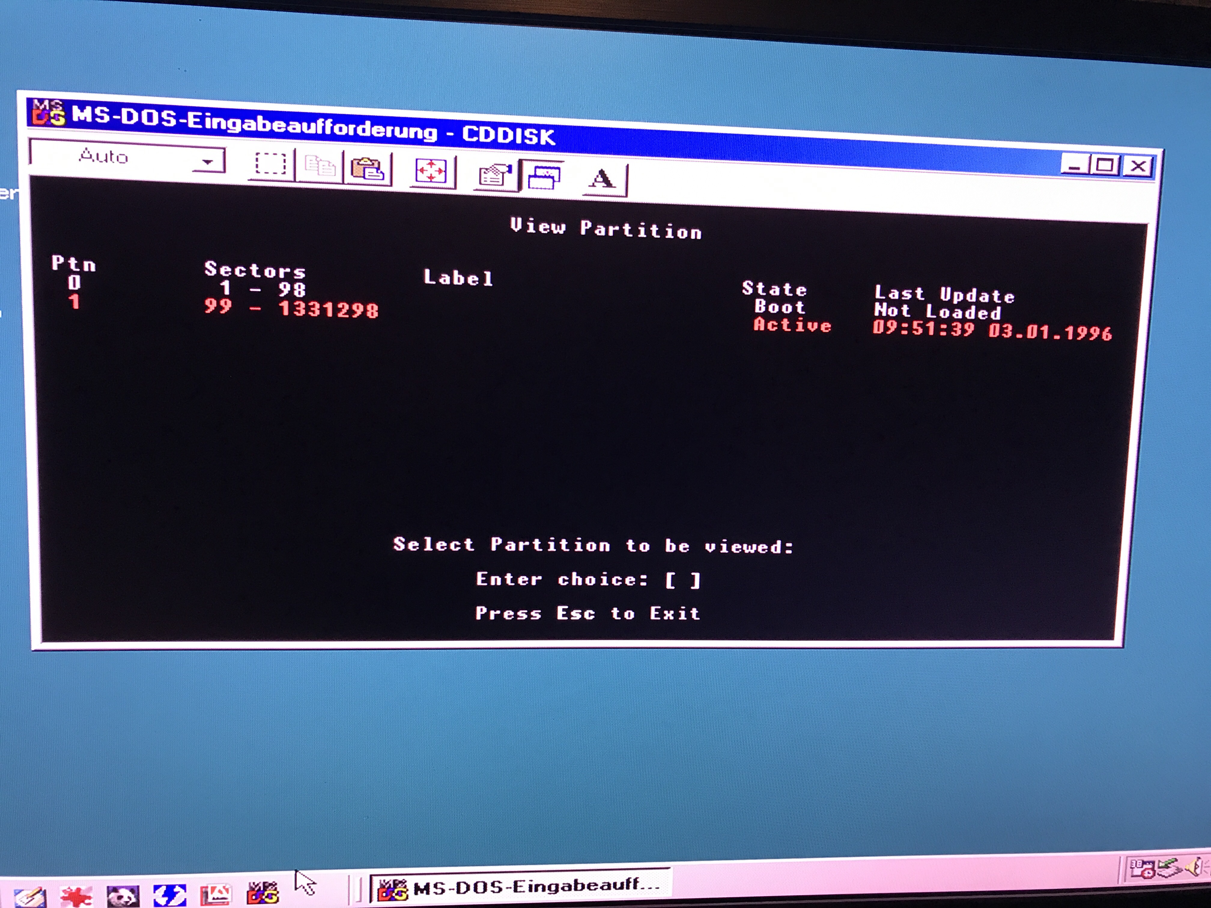

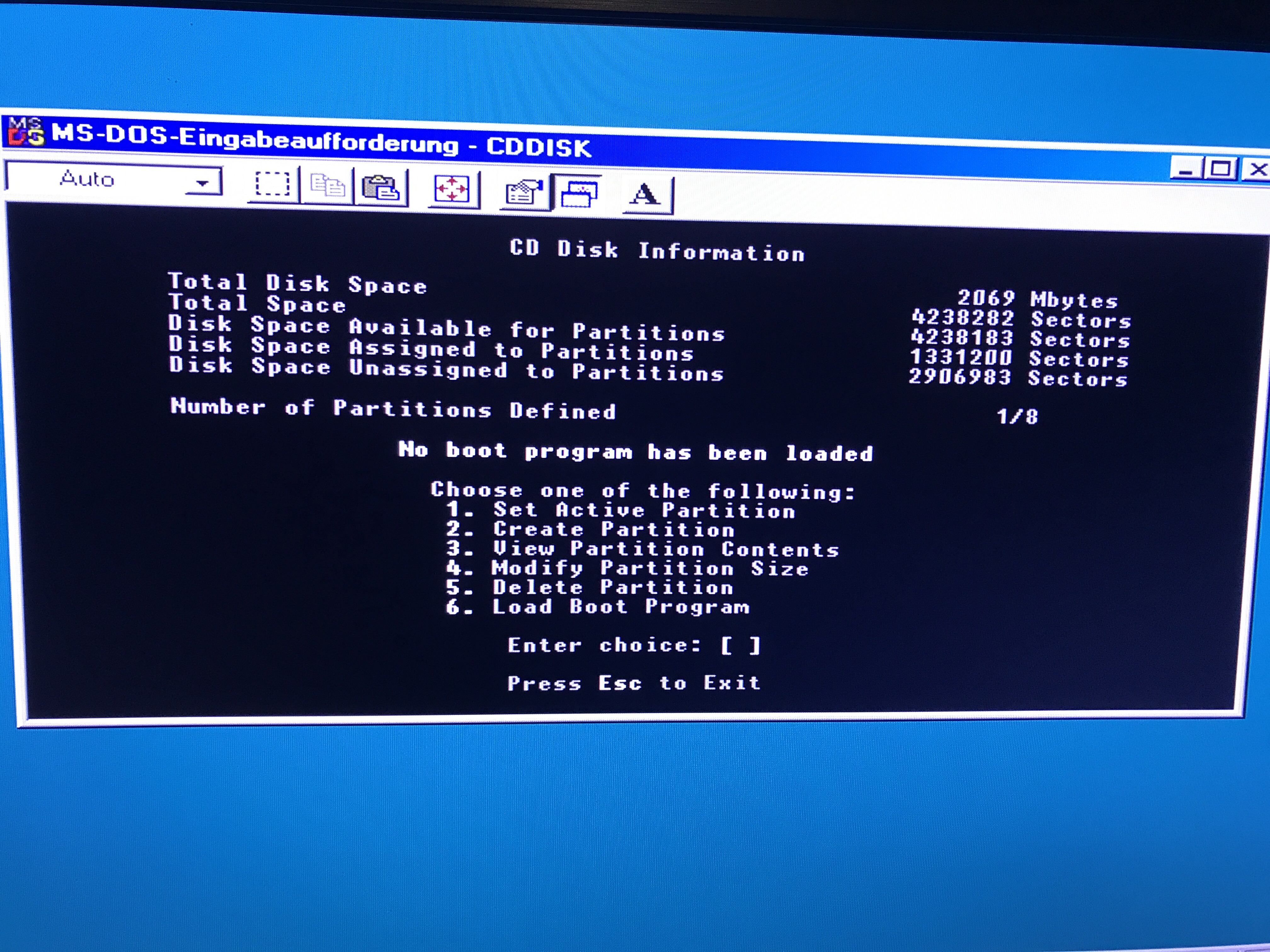

    Ok i load cddisk with id only and got this.
    has the boot parti to be active?
    Cant belive how much trouble it is to load the image...
    03.01.1996 Biohazard or Mahjong? ^^
  14. unclejun
    Nov 12, 2005
    1,912
    120

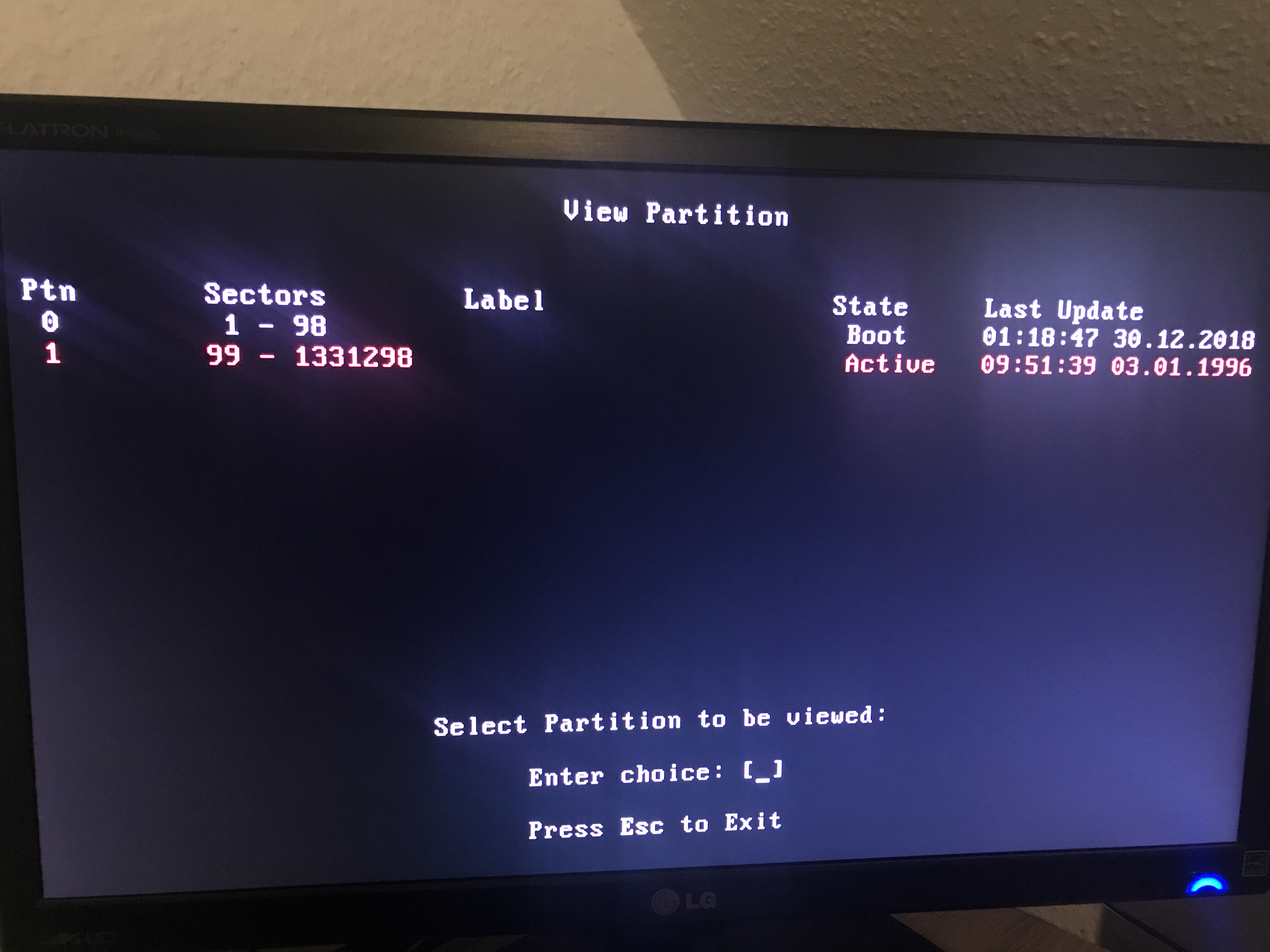

    If i recall what i read in the cd emu manual, it needs a boot loader to be loaded yes.
    Can you view the contents of partition 1?

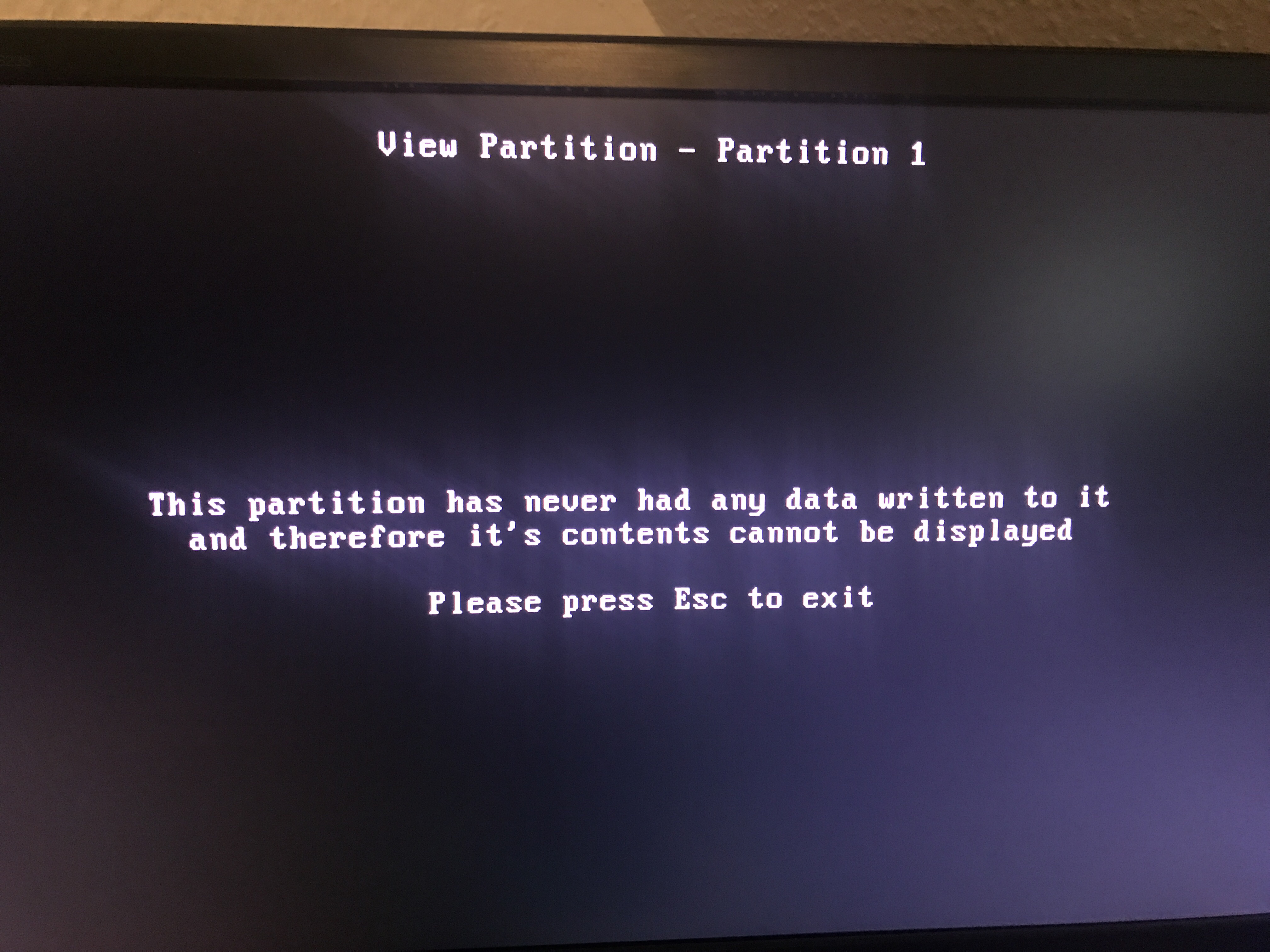

  15. Jackhead
    Jackhead Site Soldier
    Apr 2, 2008
    2,433
    610
    i load the boot36.bin into the disk with cddisk -bcdboot36.bin 5 and select in cddisk th 36 bootloader .
    But when i viewed partition 1 i got nothing there..
    I think the partition is empty at all..
    Maybe a recovery programm can find something as hi_ricky sayed before.
  16. unclejun
    Nov 12, 2005
    1,912
    120
    Weird, cause it clearly shows a 650MB partition...maybe a recovery program can help yes.
