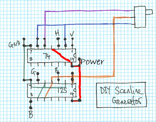

    you have a drawing or a schematic of the mod?
    because i have search and there are differents schematics with or without capacitors with or without +5V

    Here it is !

    I'm having difficulty reading this diagram. Specifically, it seems like either where you're getting the VGA picture data, or where you're sending the VGA picture data is missing, unless these chips are already in the Dreamcast. I suppose I could just try to cram my existing VGA box into the Dreamcast. Or tap the RGB off of it maybe. Whatever way I can get both RGB and VGA off the thing. Damn you Skies of Arcadia for not supporting VGA output!

    The diagram is for making a Scanlines Generator, not VGA.
