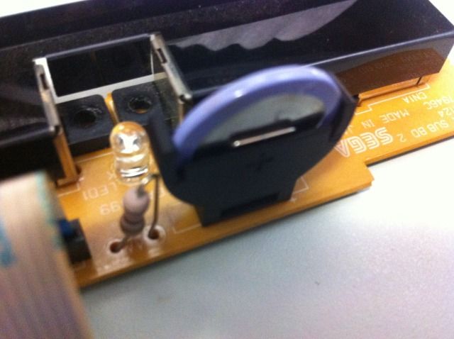

    Nice mods! Here's one I did today, it pales in comparison to what you've done, but I think it's useful:
    Now when the Dreamcast's battery dies, I can just pop the replacement in instead of having to buy a battery with the solder tabs and soldering it in :D

    D'oh! It turns out the ML2020 battery that comes with the Dreamcast is 2.0mm thick while a ML2032 (which is the size battery the holder I posted above takes) is 3.2mm thick! That would explain the loose fit and the reason why the DC isn't getting any charge from the battery :p No matter, I have a ML2032 on the way, it's 3v and rechargeable like a ML2020, so it should be a compatible replacement.

    I replace every dreamcast battery with a holder (and ML2032)
    I have not had any dreamcasts that the original battery is still working.

    Did you leave it to charge first? I thought my DC's battery was dead, but it was just flat. Worked fine after I let it charge.
    Also, why would Sega have used a ML2020 originally? They seem to be rarer than ML2032, and it's not like the battery needs to be really thin to fit, since there's plenty of room.

    Yes, they all get left on for hours. Power it off for 10 seconds and time/date has gone again.
    Holder is better for the buyer anyway, its user serviceable.

    that holder mod look great and its better than taking apart the DC just for a battery change.

    You still have to take the DC apart. You just dont need to do any soldering to replace a battery

    Well, you don't have to take it apart as much, no need to remove the PSU to get to the controller board which then needs to be unplugged. Just remove the 4 case screws, lift the top off, and pop in a new battery ;)
