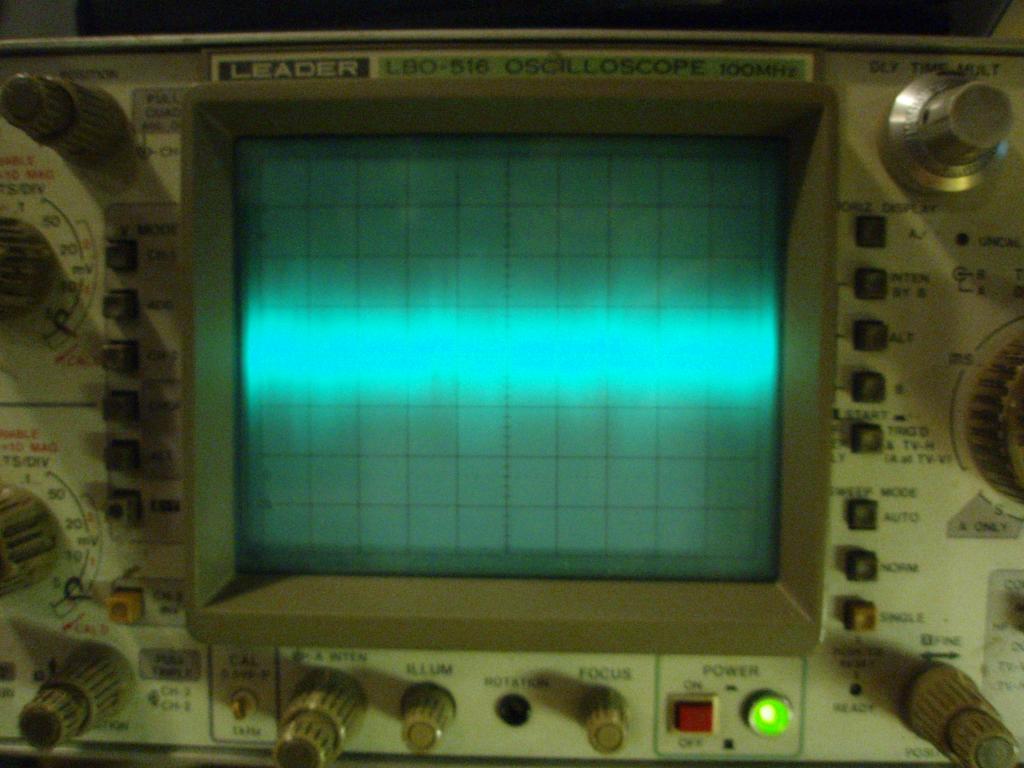

    Ok to show you how far I have gone yet, here is a direct comparison of the Background audio noise before starting this thread Vs Now. This is with same oscilloscope setting ( 20mv/div ) and Same time/div.
    It went from Insane to normal. But maybe I can make it better still! To me that is the spirit of modding, always try to make it better :)
    Before:
    And Now:
